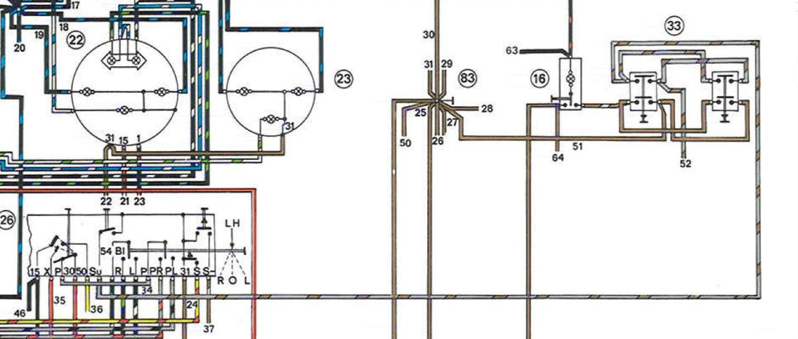

My Interior light works fine in the always ON position, but my door switches are not operating the light when you open the doors. There is no continuity between the interior light and the gray/brown wires at the door switches. Does anyone know the path of the wiring from the interior light to the door switches? The wire at the interior light is brown with gray paint on it. The wires at the door switches are gray with brown paint on them. There must be someplace where they connect?

Here is the diagram.
