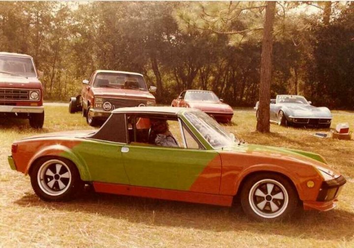

sixnotfour   Harold's 914-6 is awesome, but if lowered he w...   Feb 3 2013, 01:58 AM
speed metal army   6" Look nice on a narrow body....   Feb 3 2013, 02:04 AM
sixnotfour   Finally found a pic of what it takes to run em, 24...   Feb 3 2013, 02:22 AM
