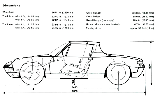

On a stock 914, the lowest point of the chassis should sit at approximately 4.5" ~ 5" inches above the ground.
If running lower profile tires this dimension could be less, so the rear donuts resting on a 4x4 timber wouldn't be subjecting the car to much of a rearward tilt.
agreed, but remember, you will need to chock or otherwise secure the front wheels, as there are no parking brakes, or gearing to stop the car from rolling backward. Assuming this things, then yes, this would work.
