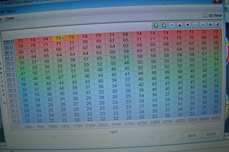

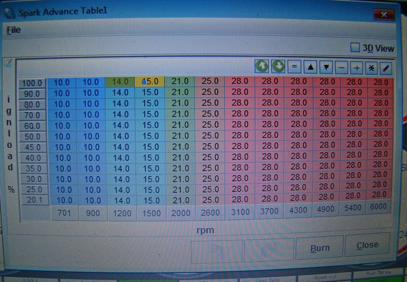

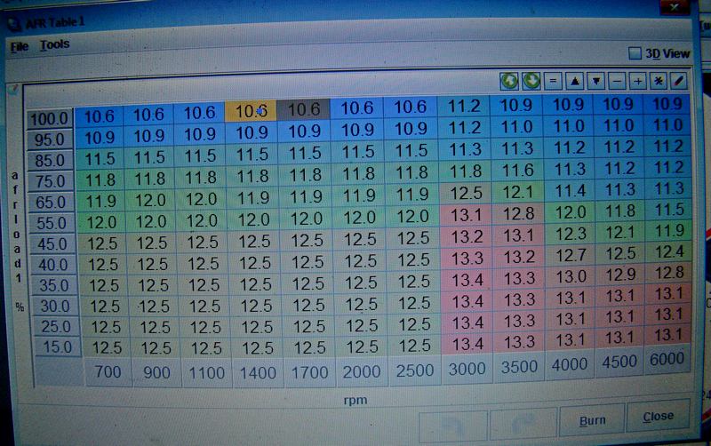

I spent a little time changing my .msq file. Please make any comment you wish. Will be starting the engine again (hopefully) tomorrow. (IMG:style_emoticons/default/smile.gif)
Here are my revised AFR, ADV, and VE tables.

Also, depending on where you are idleing you will probably need to drop the advance at 1200RPM down to around 10 or below as well. What is going to happen with your current setup is the MS will average the 900 and 1200 RPM value depending on what RPM it is as between those, so say you are idleing at 1000RPM it will have your timming around 12deg which may get you back into that runaway situation where the speed will increase and in turn cause the advance to increase.
If you set both the 900 and 1200 range to the same value then any speed between those 2 RPMs will be locked at whatever advance you set. This will help stabilize your idle quite a bit. I would probably drop both those columns down to 8deg at least.
Your target AFRs up top are pretty rich as well, I would set the max around 12.5

JamesM   Haven't had time to look over your MSQ yet (st...   Feb 6 2013, 03:58 PM
JamesM   Also, depending on where you are idleing you will ...   Feb 6 2013, 04:05 PM
jpnovak   Much better. You will find it much easier to adju...   Feb 6 2013, 04:04 PM
kg6dxn   3700 rpm @ 85% load needs to be smoothed out. If y...   Feb 6 2013, 08:18 PM
Michelj13   I could not wait until tomorrow. I changed the adv...   Feb 6 2013, 09:35 PM
