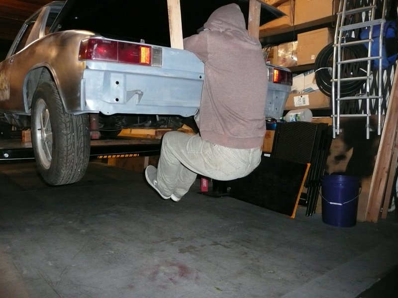

euro911   This is a very interesting idea. I have a jack th...   Feb 6 2013, 02:56 AM

euro911   Why do I have visions of Karl's Lotus Elise fl...   Feb 6 2013, 03:15 AM
KaptKaos   How many times have we had 914s up on the two-po...   Feb 6 2013, 09:46 AM

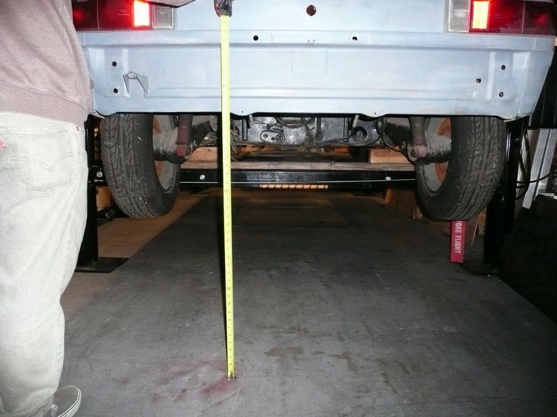

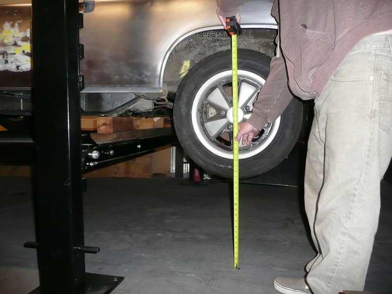

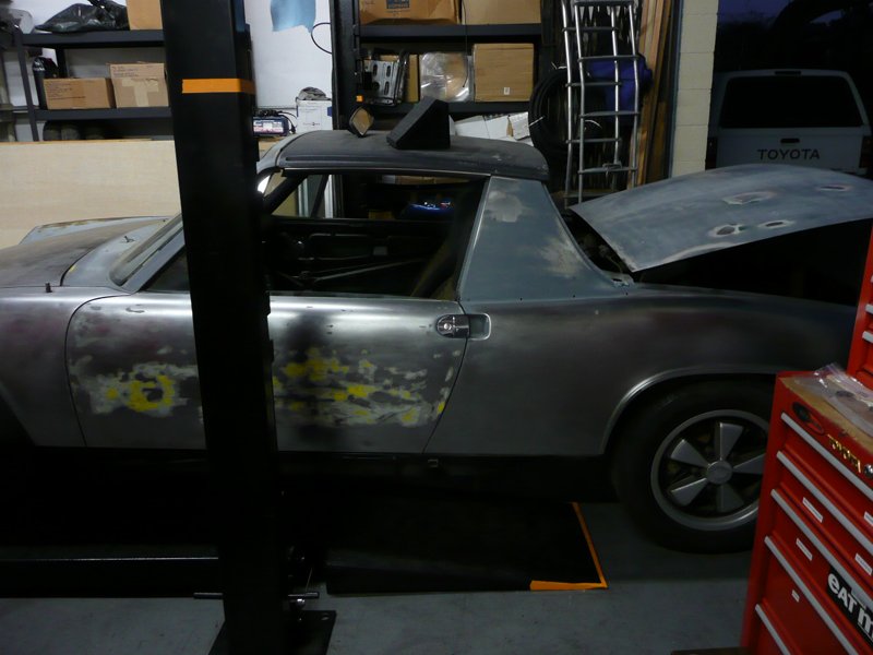

euro911   Film at eleven ...   Feb 6 2013, 05:52 PM
euro911   RE: Is it possible to drop a 1.7 using a 4 post lift?   Feb 7 2013, 12:31 AM
KaptKaos   very cool :trophy: Jeremy doesn't weigh as mu...   Feb 7 2013, 08:00 AM
euro911   very cool :trophy: Jeremy doesn't weigh as m...   Feb 7 2013, 04:12 PM
