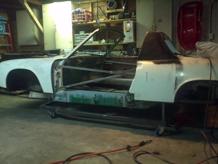

Hello all – I’ve been in lurking mode for a while (I guess two years is a while…) but have slowly made progress on my project. Thanks Rick for the response - I seem to have missed it until just now! When I ran into the door gap issues work essentially stopped until I got the car off of the rotisserie and down to Sac. I was very relieved to find that once the car was off the rotisserie the door gap problem disappeared! I even took it by a Porsche Restoration shop in West Sac and they took a loot at it for me. I know that without putting it onto a rack with the precise measurements I’ll never know how close (or far off I really am), but the door gaps are lining up now and every measurement I can take seems to be within spec and symmetric to within a couple 32nds of an inch…so, I’ve pressed onwards and hope to be a bit more diligent at posting my progress.
Since bringing the car down I have made some “upgrades” to the bracing on the car – again paying very close attention to the dimensions and all the measurements were symmetrical from driver to passenger side. Now I have a dolly that attaches at all of the suspension points and braces in each of the doors:
