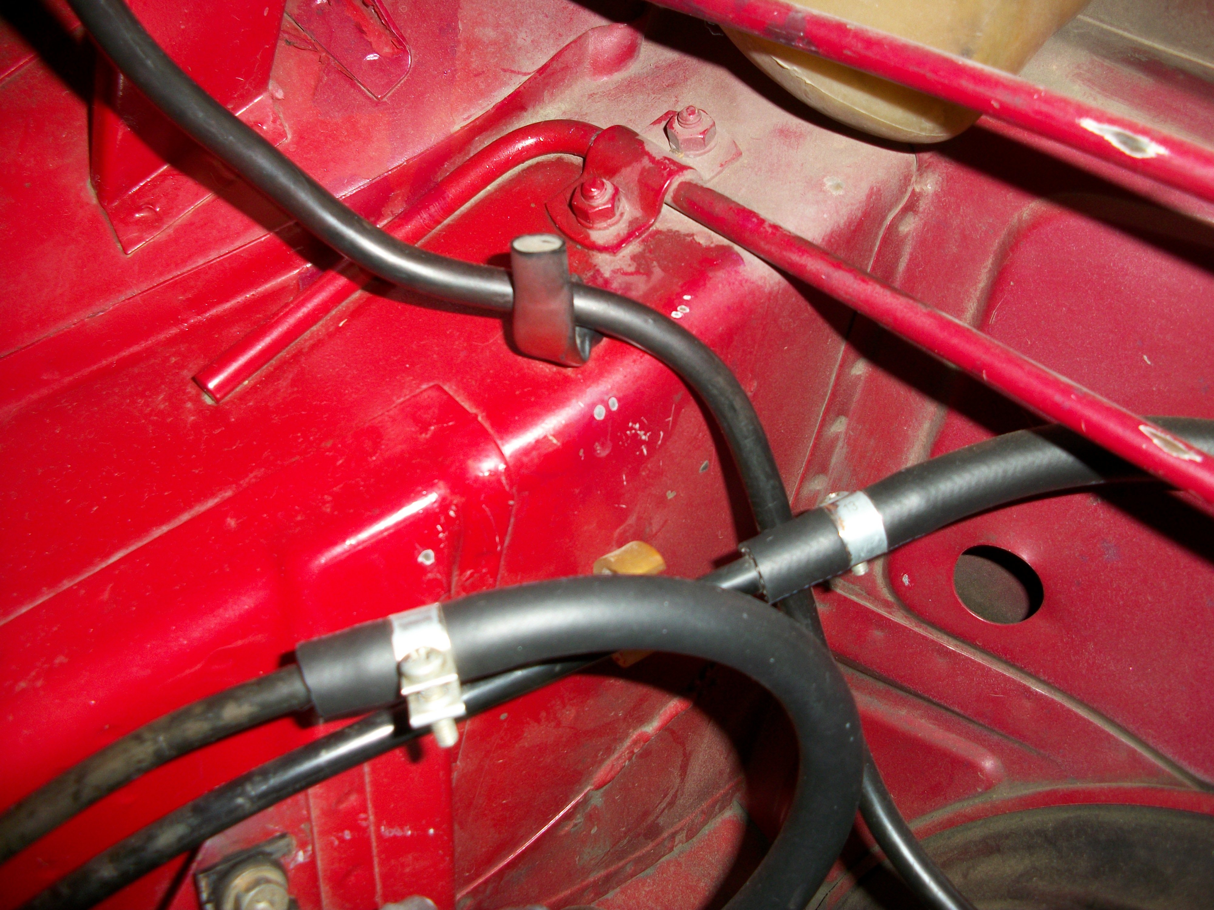

Jeff,
Here are pics of mine. As far as I can see, they are one single piece from the front pump to the engine hose connection.
John, thanks for the info. Mine are still pretty flexable. They don't seem brittle at all. I did notice the metal pieces when I had the engine out.

Tom   Jeff, Here are pics of mine. As far as I can se...   Feb 8 2013, 08:20 AM
