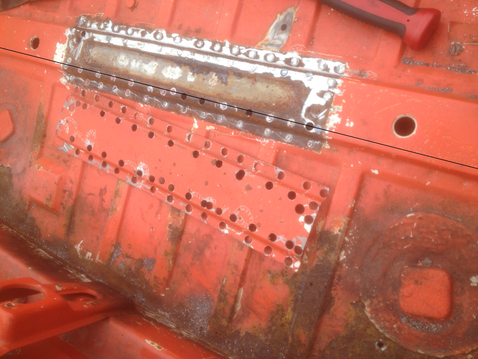

So, I just got my replacement panel from Restoration Designs for the trunk. What a beautiful part. I was thinking about making the cut just forward of the aft curve of the support, see image. Then using a flange tool to flange the car to accept the new part overlapping the car. This will let me do a better job of welding these pieces together. The rest of the spot welding can be done like the factory from the outside of the rear apron. The original brace can then attach on top of the cross member.
What do you think? (IMG:style_emoticons/default/sawzall-smiley.gif)

OU8AVW   I started to remove the rear trunk pan. Using an a...   Feb 11 2013, 09:03 AM
OU8AVW   So, I just got my replacement panel from Restorati...   Feb 11 2013, 09:12 AM
