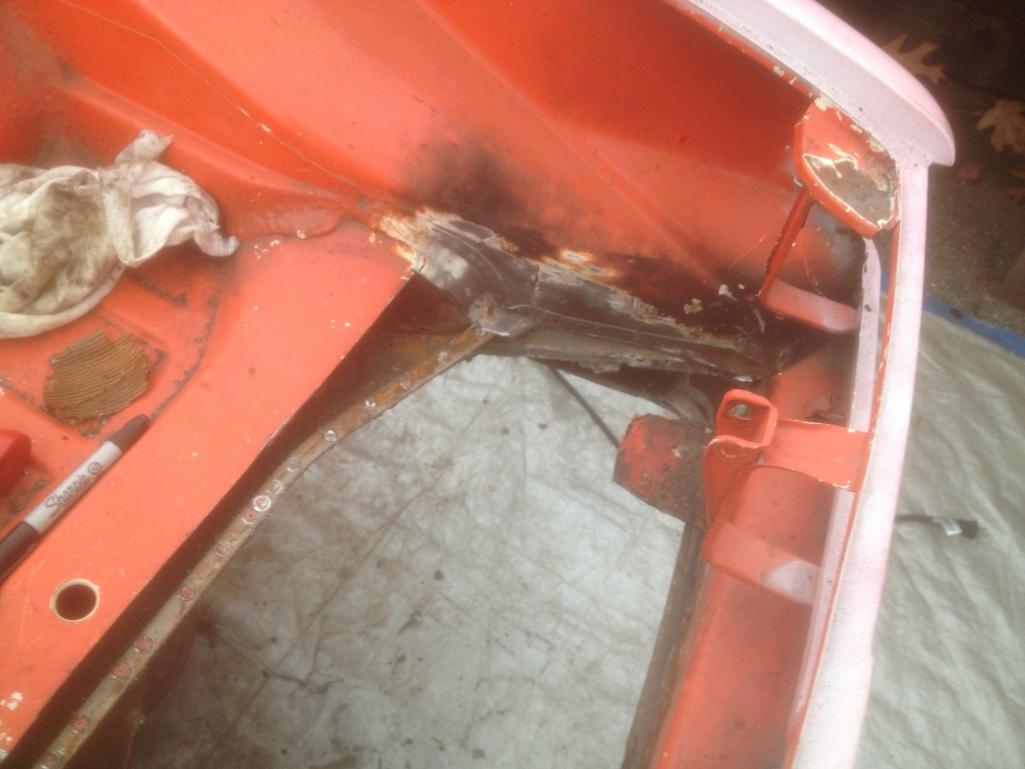

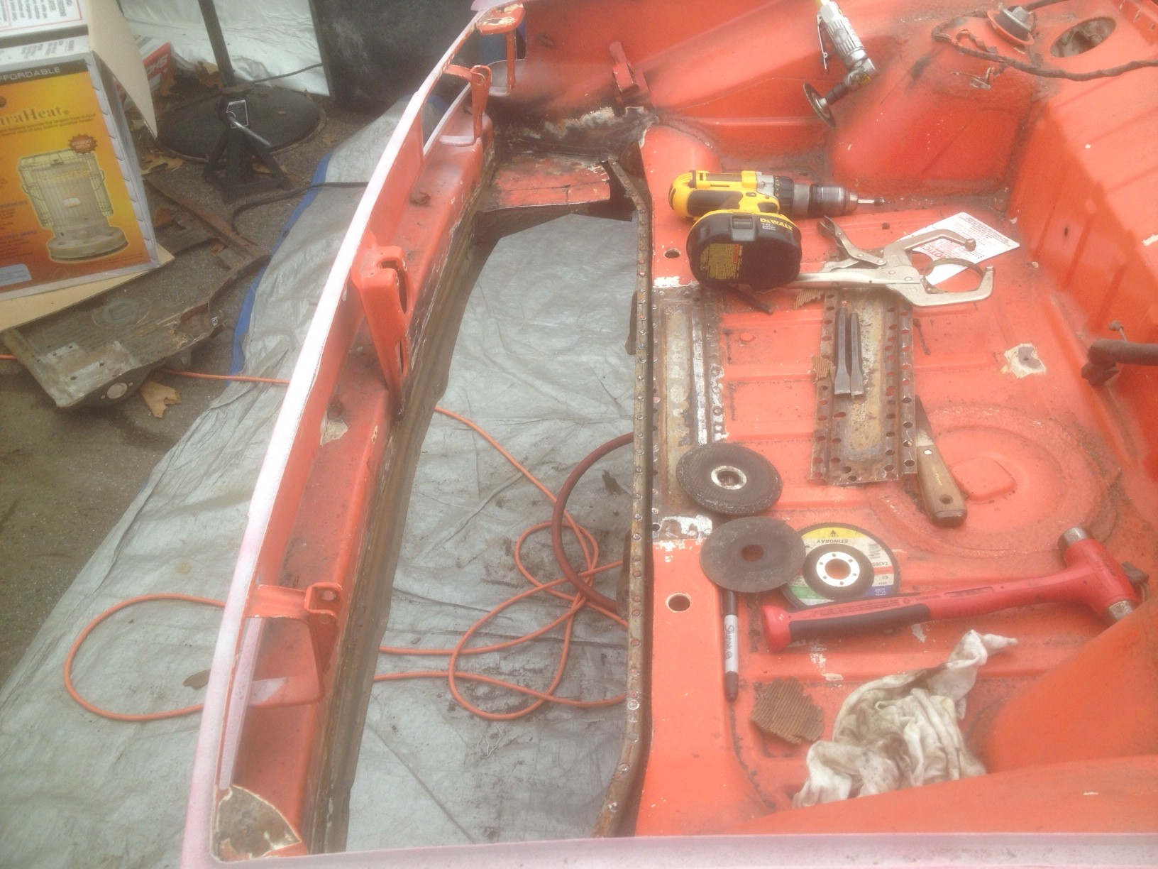

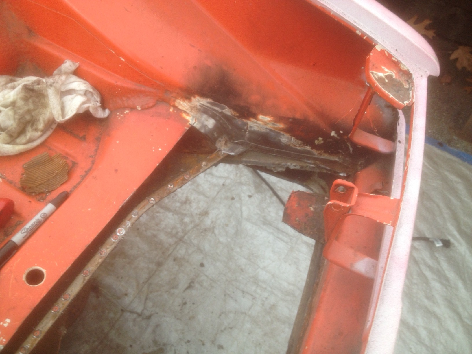

I had some time this weekend and got the rear trunk pan removed. I cut along the trailing edge of the trans support. An air saw got the aft end of the pan removed close enough to the welds that I could grind down the remaining material with little effort.
