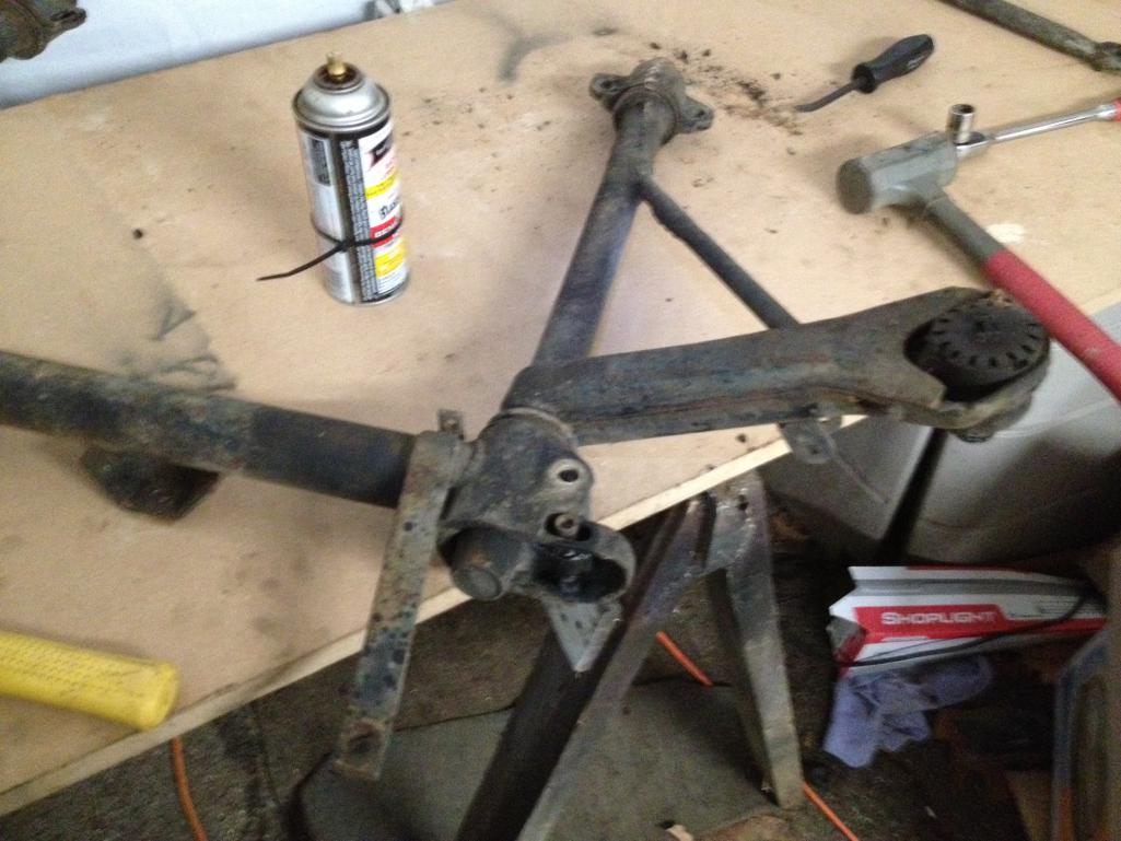

Ok, any tips on removing the torsion bars? I got the A-arms off the crossbeam but I cant's get the torsion bars free....

OU8AVW   Ok, any tips on removing the torsion bars? I got t...   Feb 20 2013, 10:37 AM
FourBlades   It is dirt in the splines holding it in. Turn it ...   Feb 20 2013, 11:14 AM
