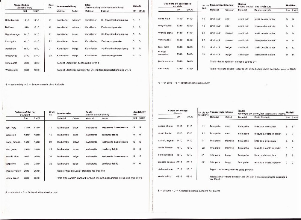

As for your interior code #21 - it should read Brown Leatherette with Basketweave (inserts), as per this chart I used to get mine corrected from their erroneous "#31 Beige..." - which was their error....
^--- note #21 in bottom left set of English codes, this is from Jeff's website too BTW
