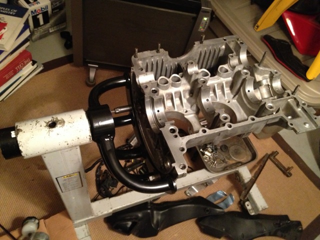

First things first I decided to ditch my crappy two-arm VW engine stand for a five arm jobby. It was $89, which is a lot cheaper then the other more heavy duty available options, and I was frustrated by the fact that I could have made one with $10 worth of steel and a few hours, but who has that time!
All and all I like the stand, and it was worth the savings for me in effort, so I can focus on actually getting the engine back together!

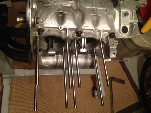

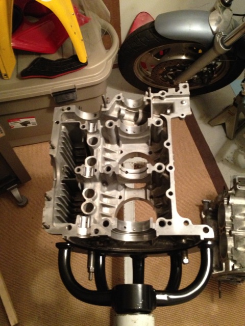

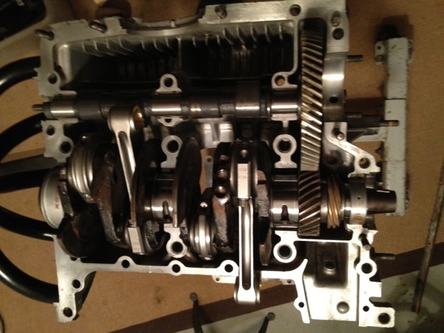

I did a dry assembly of everything to make sure that I had the clearance necessary for my crank/cam combo, and I could not find any issues!!

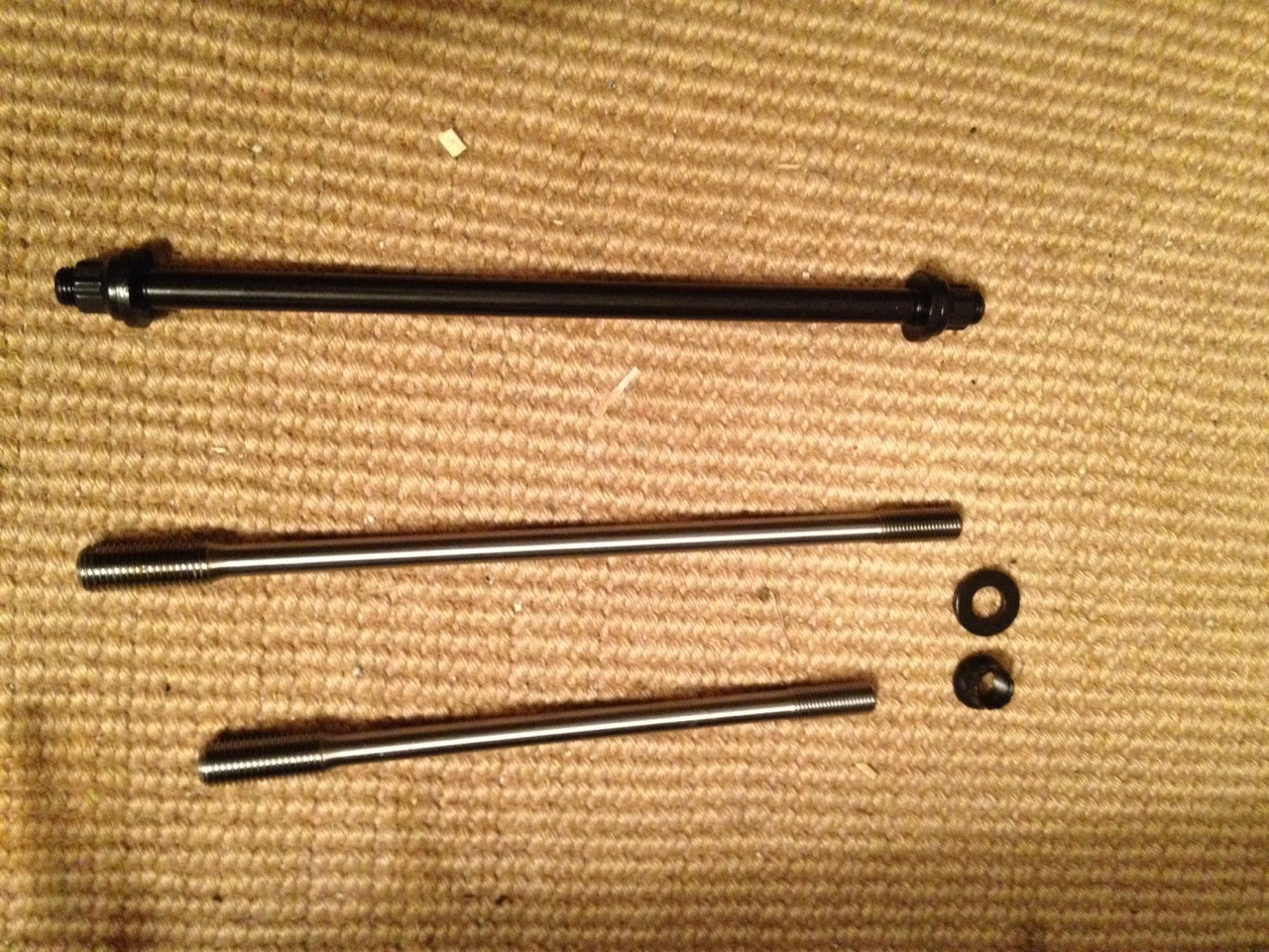

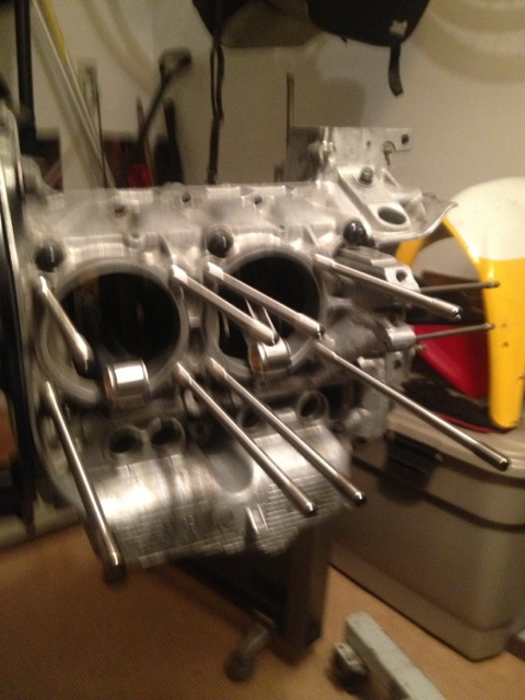

I then started to install the ARP head studs I ordered, which if you have never seen these in person they are very impressively constructed. Worth the money? Well I really have no empirical way to determine that, but they do give me a sense of security, perceived or real I think that is a good thing. I really would like this engine to last, and I feel like these parts are things that I can use in the future if I want to play with the internals some more.
I unfortunately discovered that my ARP kit was missing one stud from LNengineering, but a tic later one was in the mail to me! As has been stated before, they are a stand up set of folks to deal with and I would not hesitate to recommend them to someone else.
