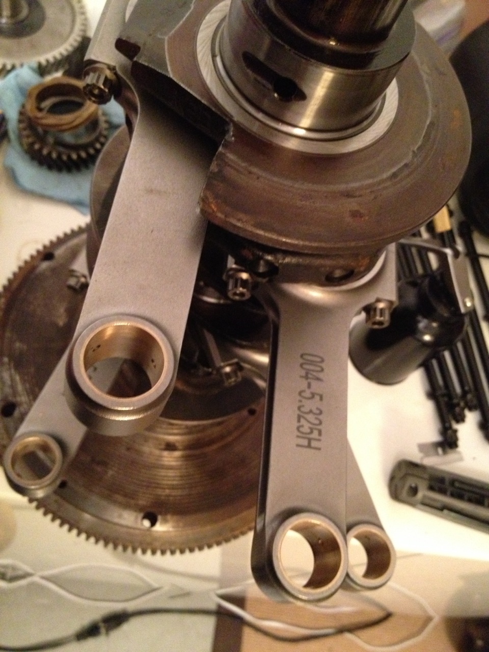

I am not sure which way the rods are supposed to face...Jake Rabys video indicates that all of them should have the numbers facing the same direction on the crank when you go to install them (facing "up") I assume this applies to the aftermarket ones as well?
Also, I am not sure if I should use a thread sealant on the ARP Head studs when I reinstall them, any opinions here appreciated! Then on to final assembly!!
