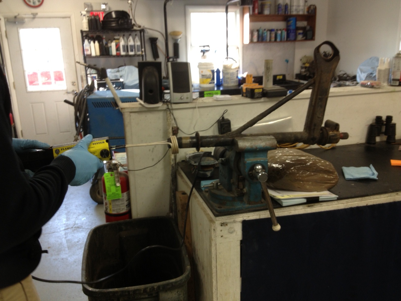

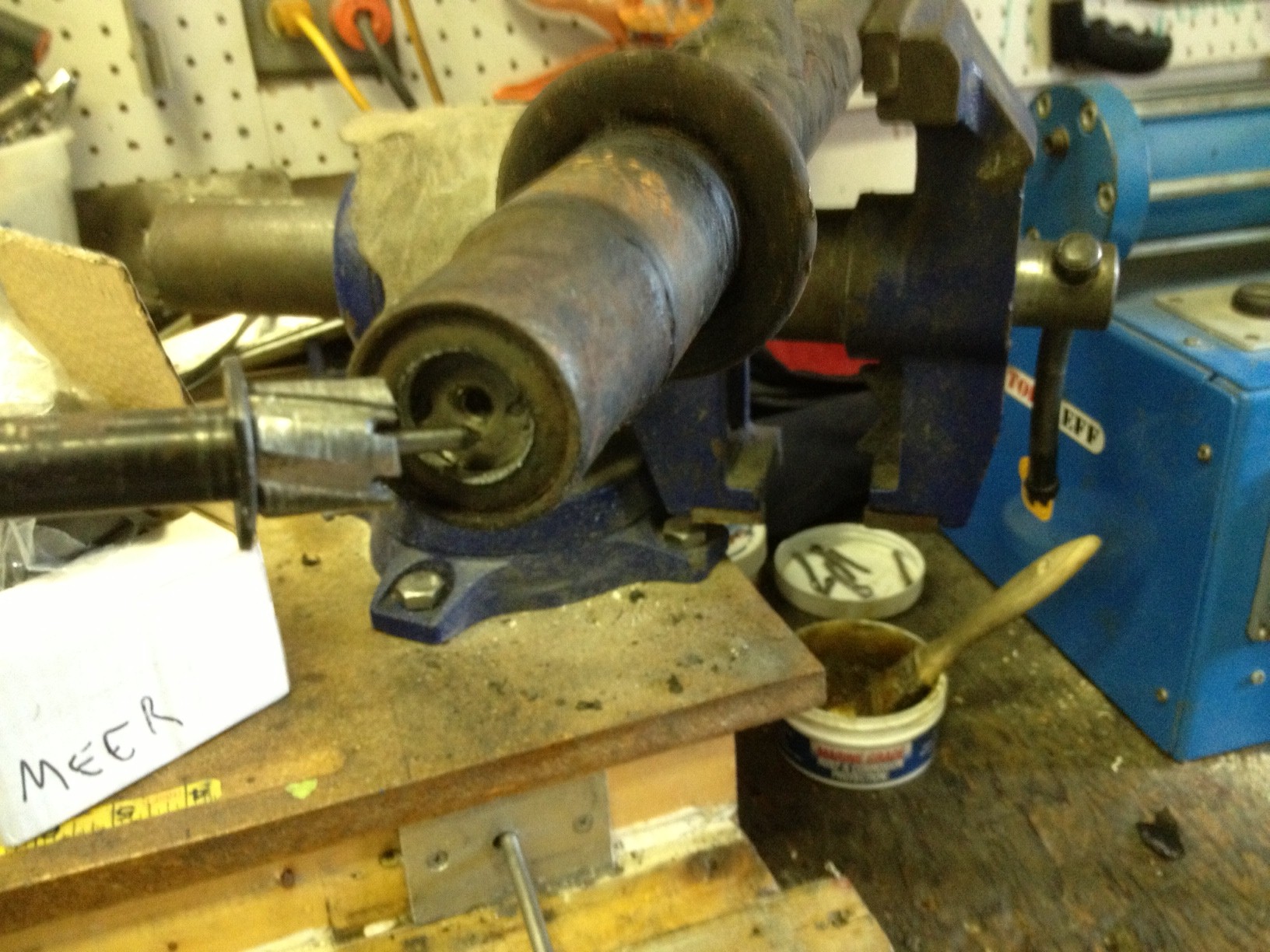

Working on the restoration of the front suspension. Removing the torsion bars and bushings....

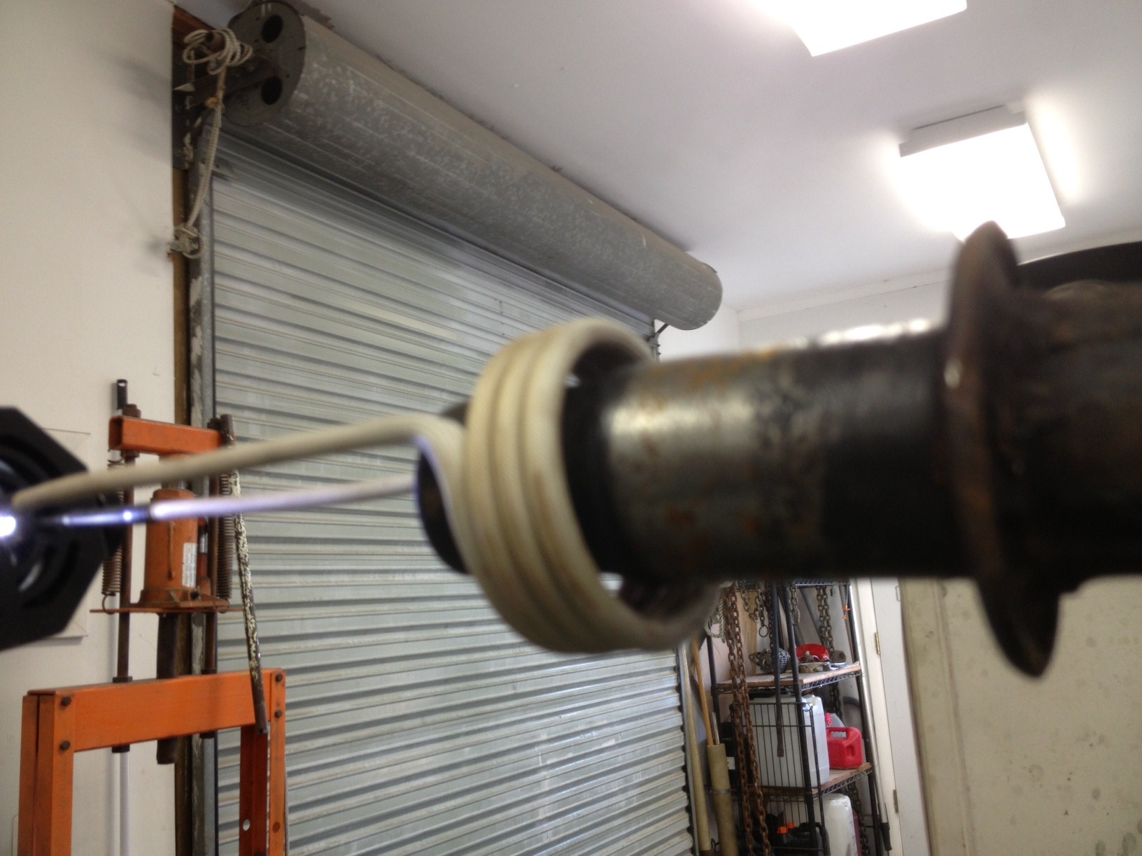

The torsion bars were pretty frozen so I drilled out the forward caps with an anular ring cutter and used a Mini Inductor to heat things up.
Cool tool! It uses an electrical field to heat metal to white hot is seconds. The tool itself stays cool to the touch as does any non-metallic items in the field.
Heats up in less than 30 seconds

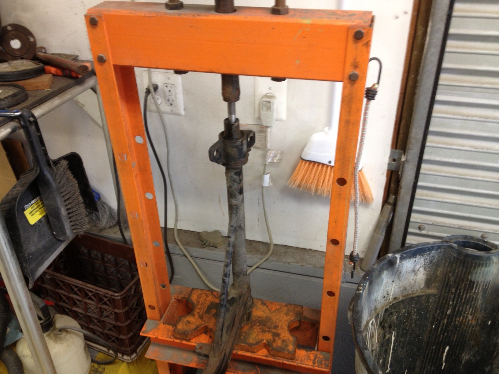

Then a little pressure with the press.
