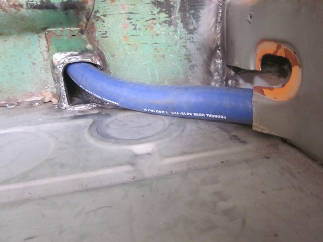

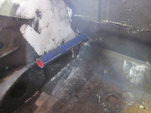

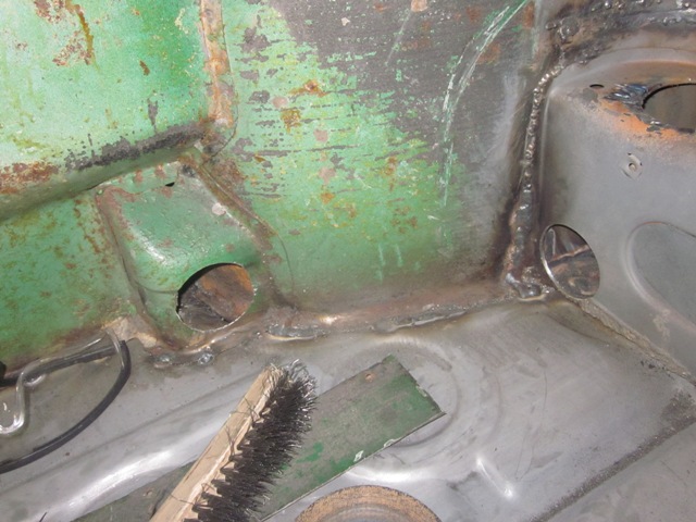

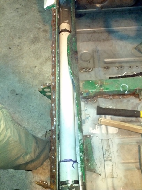

With the rear trunk mods and rust repair finished (minus the cover panel) I focused my attention to pluming the coolant lines. For this I had the following criteria in mind:
1) Protect the hoses!
2) Keep the car nice and flat underneath
3) Limit heat from hoses to cabin
4) Enable easy future servicing
5) Limit number of connections (i.e. future leaks)
6) Hide the evidence

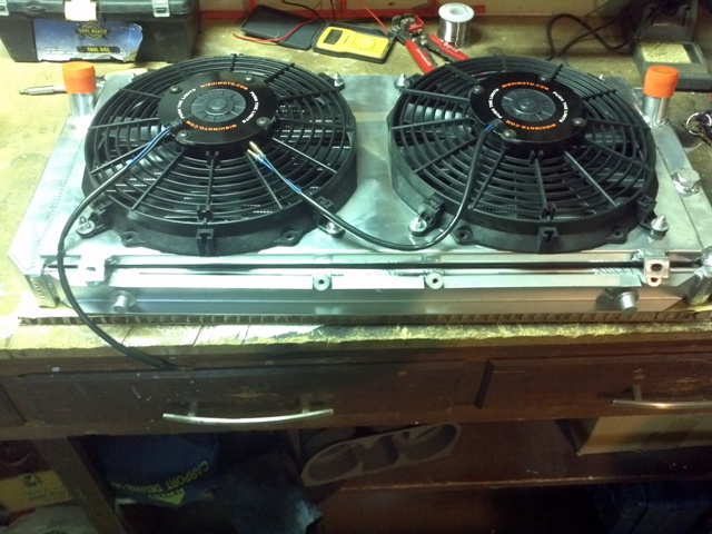

I played around with some different ideas but finally came to the conclusion that routing the coolant lines through the longs made the most sense. In order to enable installation and removal of the hoses from the engine bay I knew I would need to run a chase down the tubes (FYI the original heater tubes had been chewed up long ago by mice). Ideally this chase would also be used to help insulate the cabin as well. In the end I went with PVC pipe for the chase (I know, it seems kinda hokey but I think it makes sense). The PVC was the only readily available rigid pipe material I could think of that could offer some insulation without absorbing moisture or trapping water against the metal. For the sections the route through the cabin I plan to "get my fiberglass on" and make some cover panels. I also plan on adding some foam insulation behind the panels. Also, a gratuitous picture of the new radiator and cooling shroud
