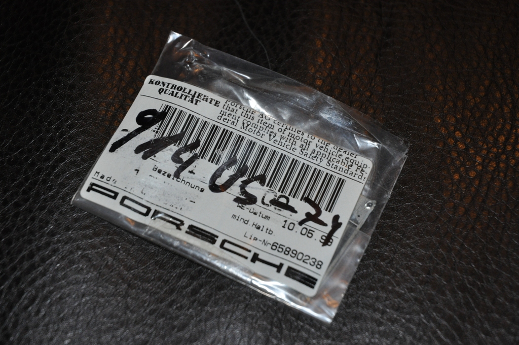

got the NOS plate from a guy in Germany that had a lot of -6 stuff. The hard part was finding the correct stamps. Sadly the P/N is not readable on the sticker

rgolia   well I got it off and hit it with acetone....this ...   Mar 20 2013, 04:40 PM
