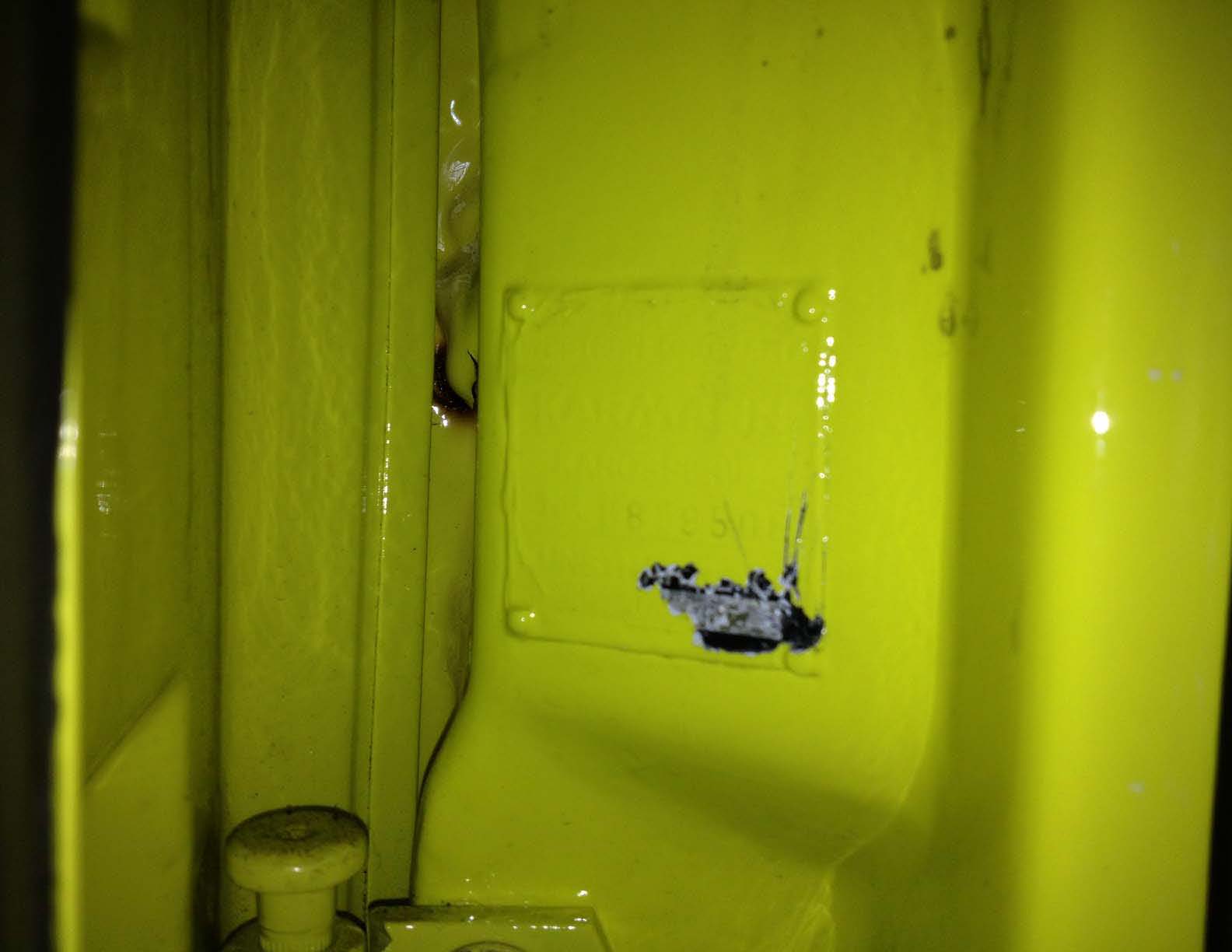

Any suggestions on how to save it or am I just screwed
Click to view attachmentClick to view attachment Well it looks like crap but better than painted over.

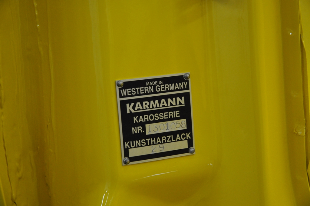

Andy just went through this. You can reuse the pins.
Click HereClick to view attachment

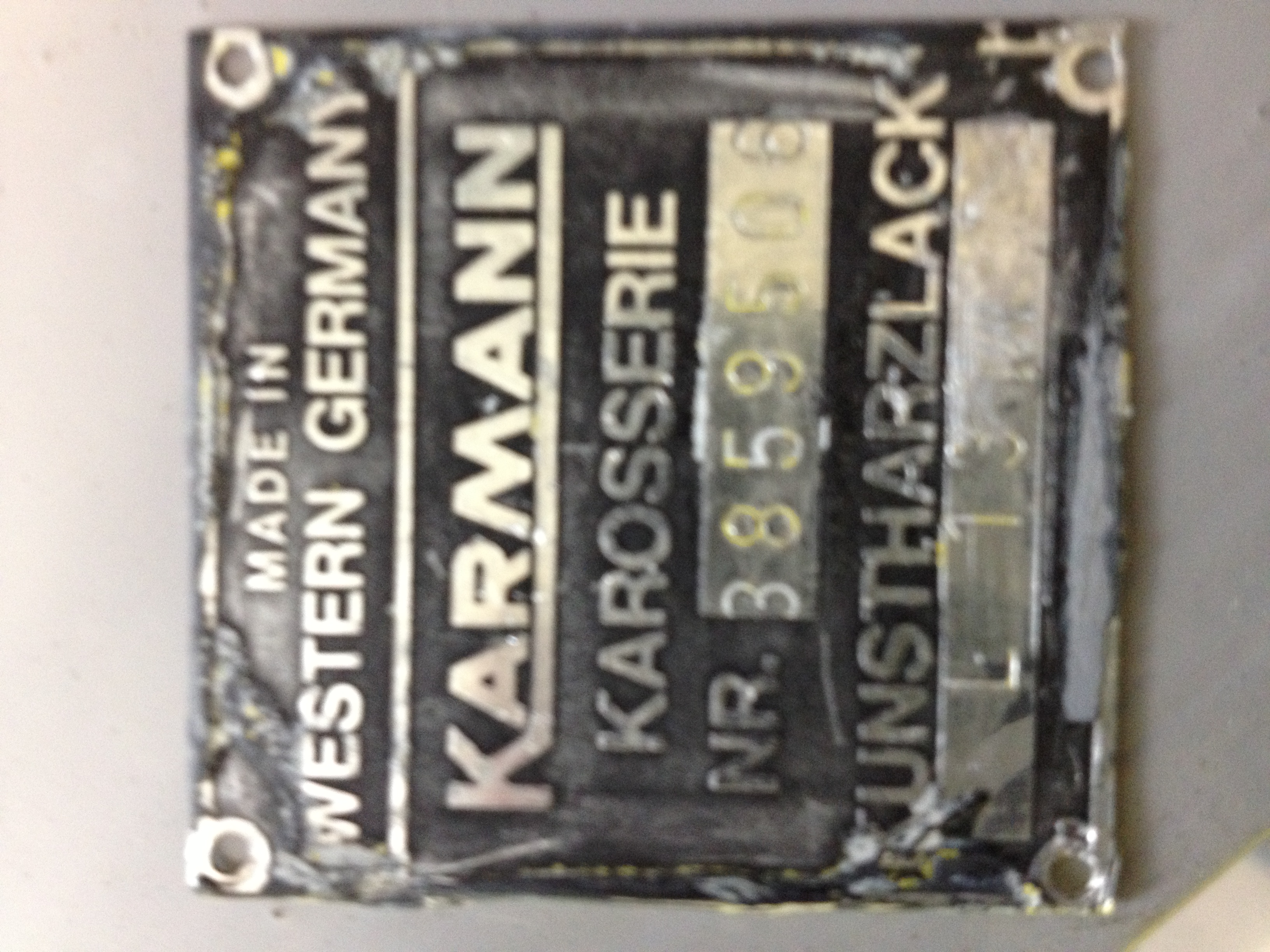

rgolia
Mar 20 2013, 04:40 PM
well I got it off and hit it with acetone....this is what I got. Not pretty but better than painted. Would love a replacement...but oh well.
