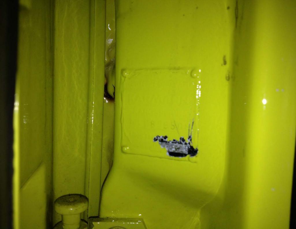

> how do I save this? I removed it and hit it with acetone, my buddy the body shop dude painted this over

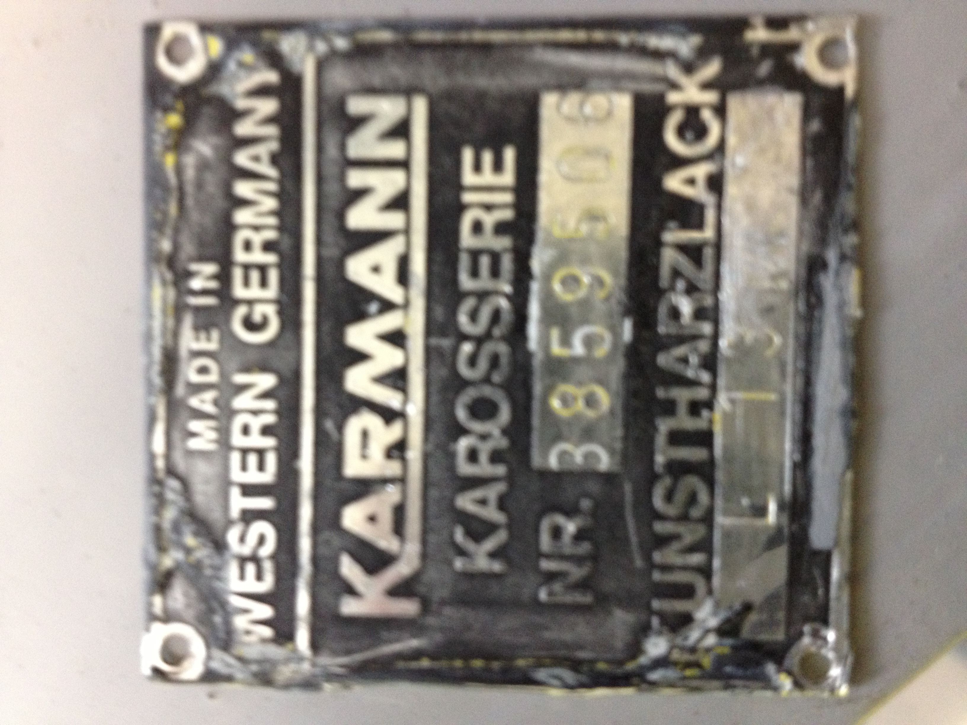

Any suggestions on how to save it or am I just screwed (IMG:style_emoticons/default/sheeplove.gif) ?Attached ImageAttached Image Well it looks like crap but better than painted over.

QUOTE(rgolia @ Mar 4 2013, 01:03 PM) *
Anything that isn't sharp or metal. Try a dull plastic knife or some such ...

possibly tape and paint remover.
It might work to soften the paint if you do it quick...dont leave it on too long.
then, use a plastic scraper like Andy said.

try goof off or graffiti remover. i have seen threads on the samba where guys remove the second paint jobs on vws. they will do the whole car to get down to the original paint. (IMG:style_emoticons/default/pray.gif)

QUOTE(r_towle @ Mar 4 2013, 01:16 PM) *
rich
I've removed paint from old power tools that have been repainted by previous owners. I used a mild "Citristrip" paint remover and found that the new paint is a lot softer then the old paint and comes off much easier. It'll start to peel quickly while the original paint remains intact.

I might be tempted to grind off the rivets and remove the plate. Clean the area and have him touch the spot where it was. There must be and easy way to clean it once removed. The sooner the better

Don't use paint remover or solvents! The first thing that will come off is the black, and you'll be left with a bare aluminum plate with some numbers stamped on it!

I used Acetone on Q-tips & carefully eased & worked it off gently, to get off 4 over sprays. It works but takes time & patience, and you may need to touch up some of the black painted areas with matte black paint it you go too far.
I wouldn't use masking tape without first scoring the edge of the plate, since the acetone could wick up under the tape & onto the paint you don't want to remove.
Go slow & gently & acetone will work. Also leave a few minutes for the paint to bubble up after your first wetting. Keep the Q-tips relative dryish with acetone, as you do not want any running!

I would try plastic razor blades like these

Tape it off and wd40 and a soft brass dremm tool. Go slow and easy. Cut around it with a razor knife before starting

Those are not rivets holding the plate on, they are push pins with spiral grooves. Remove the speaker grill and they can be tapped out from the backside.

QUOTE(Bartlett 914 @ Mar 4 2013, 04:45 PM) *
(IMG:style_emoticons/default/agree.gif) It won't look right unless the tag is ON TOP of the paint. You can touch up the area yourself since the paint is fresh. Also be careful what you scrape it with, that tag is somewhat fragile.

QUOTE(ejm @ Mar 7 2013, 07:53 AM) *
(IMG:style_emoticons/default/agree.gif) I didn't realize you could get to them behind. That would make it easy to save them. They are a metric size. You can get similar push rivets here but the size is a little different an may require opening the holes

Definitely would want to score around the plate all the way down through the primer, otherwise it's going to pull all the new paint and probably the old paint off the door jamb when the plate is taken off.
