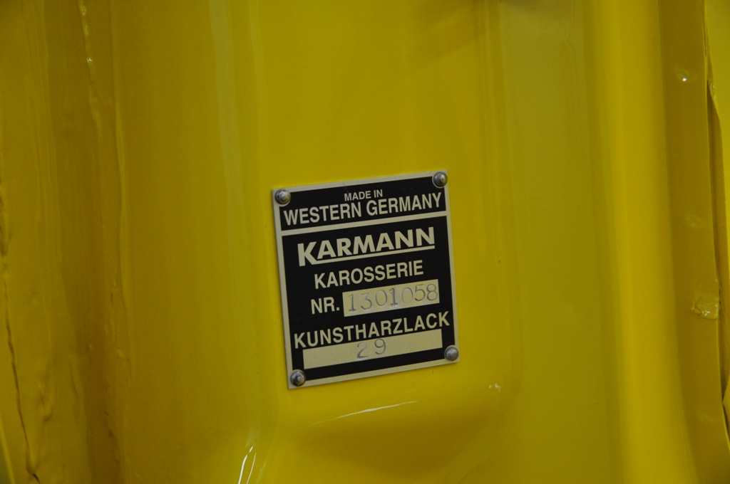

> how do I save this? I removed it and hit it with acetone, my buddy the body shop dude painted this over

Any suggestions on how to save it or am I just screwed (IMG:style_emoticons/default/sheeplove.gif) ?Attached ImageAttached Image Well it looks like crap but better than painted over.

Definitely would want to score around the plate all the way down through the primer, otherwise it's going to pull all the new paint and probably the old paint off the door jamb when the plate is taken off.

QUOTE(914GT @ Mar 7 2013, 08:32 AM) *
and
QUOTE(ejm @ Mar 7 2013, 05:53 AM) *
Those are not rivets holding the plate on, they are push pins with spiral grooves. Remove the speaker grill and they can be tapped out from the backside.
Andy just went through this. You can reuse the pins. Click Here

r_towle   possibly tape and paint remover. It might work to ...   Mar 4 2013, 03:16 PM

mrbubblehead   try goof off or graffiti remover. i have seen thre...   Mar 4 2013, 03:31 PM

Bartlett 914   I might be tempted to grind off the rivets and rem...   Mar 4 2013, 04:45 PM

John1180   Don't use paint remover or solvents! The f...   Mar 4 2013, 04:51 PM
Tom_T   I used Acetone on Q-tips & carefully eased ...   Mar 4 2013, 05:32 PM
dpires914   I would try plastic razor blades like these http:...   Mar 4 2013, 05:51 PM

bandjoey   Tape it off and wd40 and a soft brass dremm tool. ...   Mar 4 2013, 06:09 PM
ejm   Those are not rivets holding the plate on, they ar...   Mar 7 2013, 07:53 AM

toadman   I have removed dried, overspray paint from chrome ...   Mar 7 2013, 11:03 AM

ejm   The parts catalog lists a "badge for lacque...   Mar 8 2013, 05:04 PM
rgolia   well I got it off and hit it with acetone....this ...   Mar 20 2013, 04:40 PM
