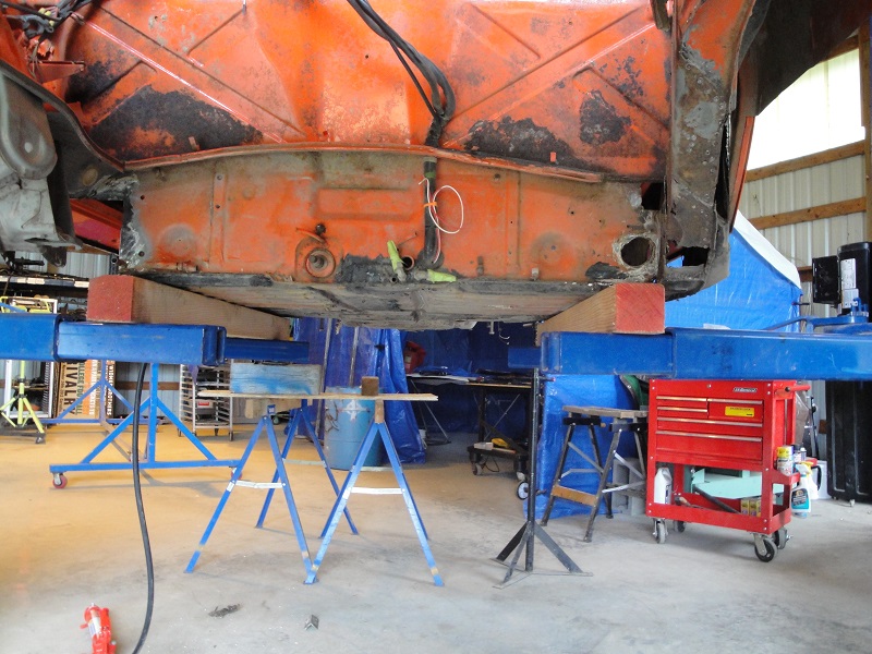

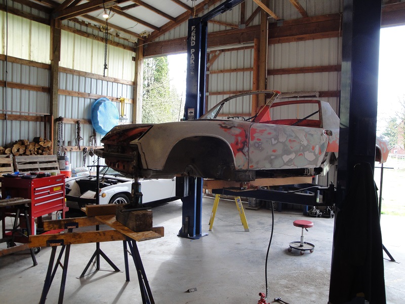

cary   Here's the body supported on the lift.   Mar 15 2013, 09:01 AM
