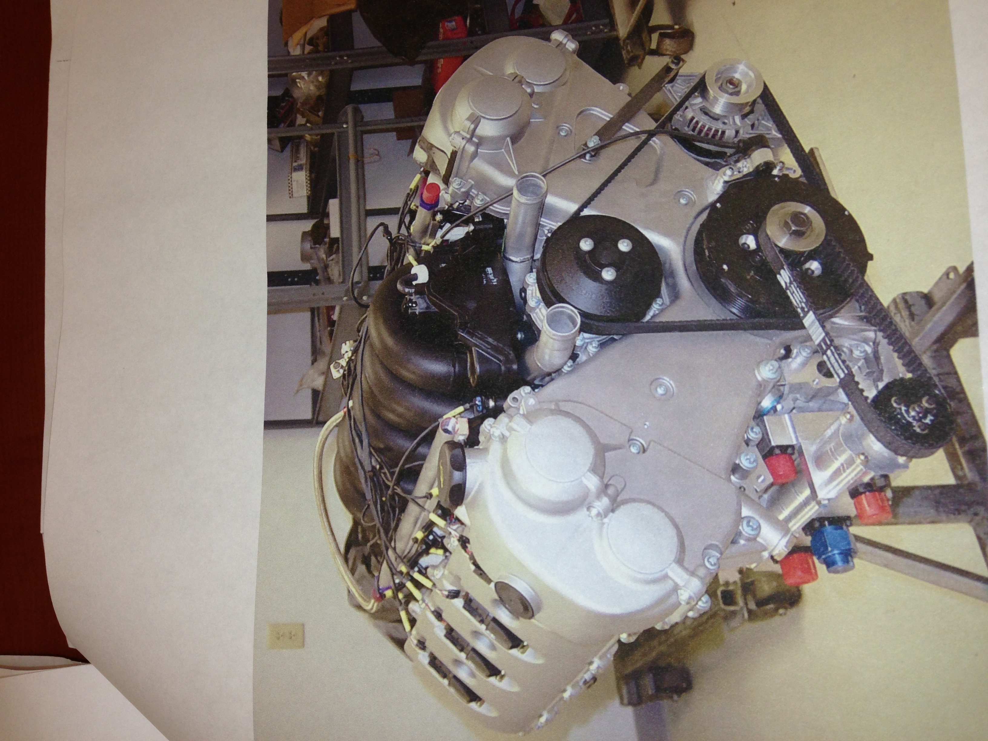

What the engine will 99.9% look like when finished, and yes this is the 2010 Daytona Prototype (and Cayenne V8 all motor) winning car that you were just trying to remember.

An LBP 5.0 cayenne v8 n/a built to Daytona Prototype spec.
Circa 2010.

QUOTE(Maltese Falcon @ Mar 15 2013, 04:27 PM) *
Circa 2010.
Marty Attached Image
Cool build! Are you going to stiffen stock chassis or build a tube chassis? What about weight distribution as well? That engine & tranny look heavy. Can't wait to see it come together! Good luck!
Tom
