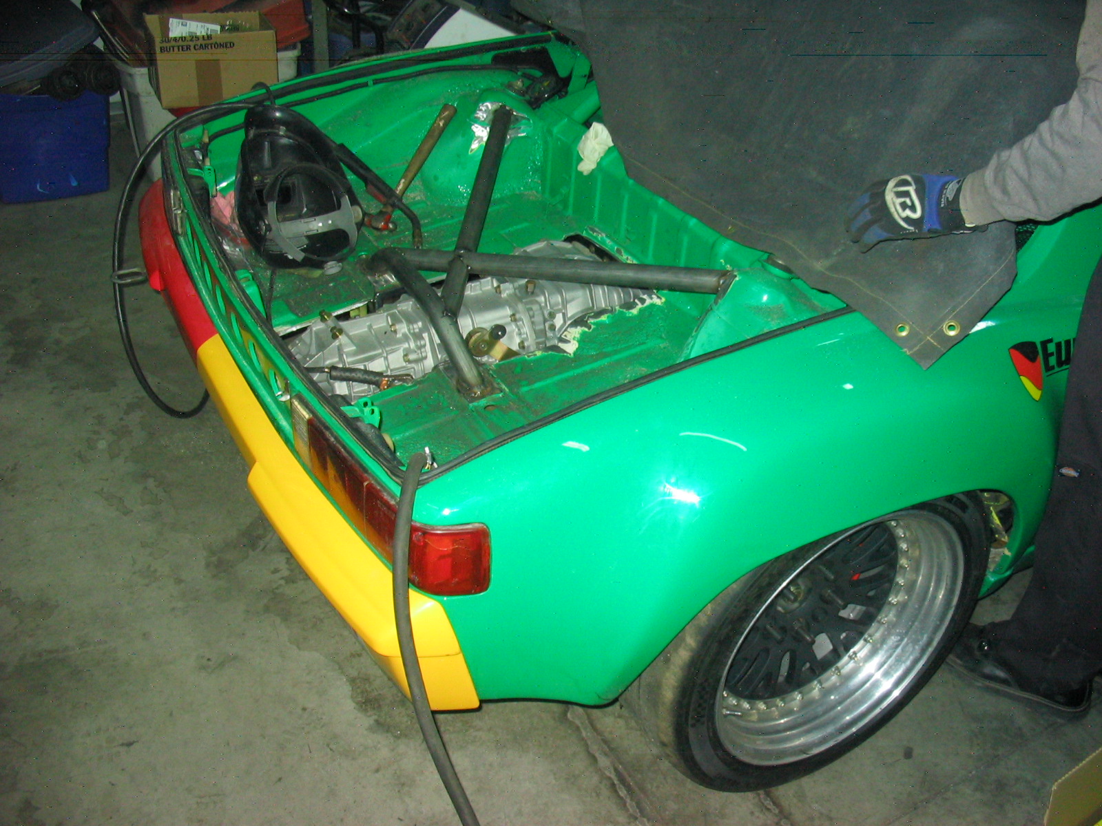

This is the Loss of trunk space when using an inverted 996gt2
Transaxle. Our build will eliminate most of the trunk floor.
Photo courtesy CMS.Attached Image
