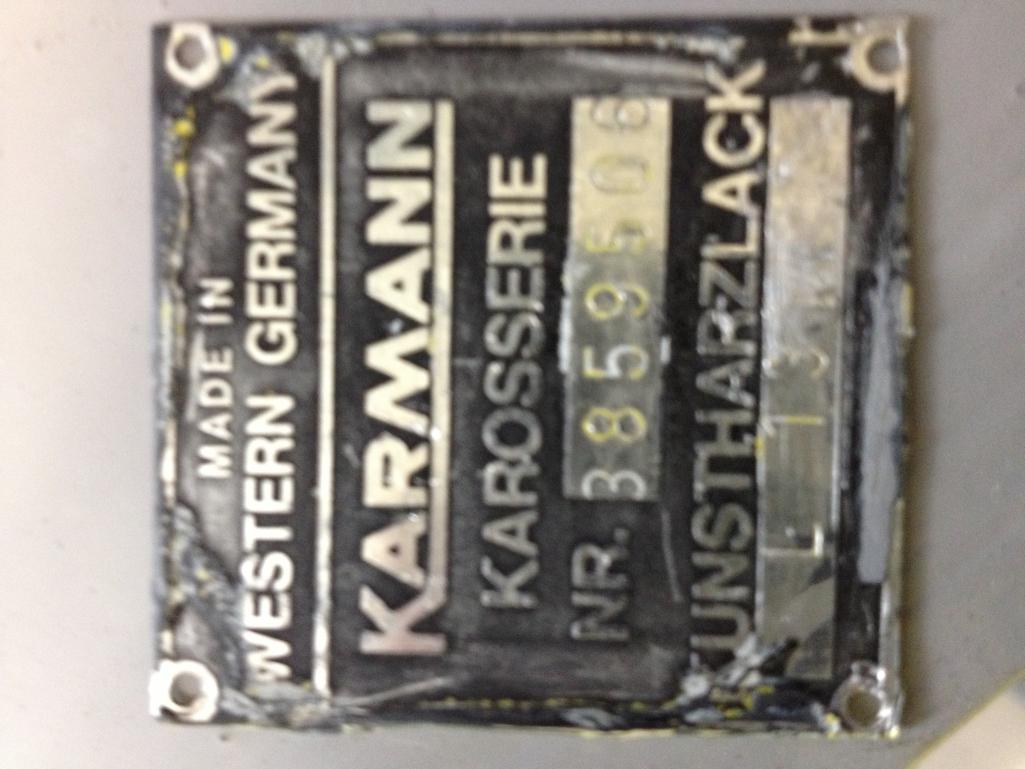

> how do I save this? I removed it and hit it with acetone, my buddy the body shop dude painted this over

Any suggestions on how to save it or am I just screwed (IMG:style_emoticons/default/sheeplove.gif) ?Attached ImageAttached Image Well it looks like crap but better than painted over.

well I got it off and hit it with acetone....this is what I got. Not pretty but better than painted. Would love a replacement...but oh well. Attached Image

SirAndy   Any suggestions on how to save it or am I just sc...   Mar 4 2013, 03:07 PM
r_towle   possibly tape and paint remover. It might work to ...   Mar 4 2013, 03:16 PM
MrKona   possibly tape and paint remover. It might work to...   Mar 4 2013, 04:16 PM

mrbubblehead   try goof off or graffiti remover. i have seen thre...   Mar 4 2013, 03:31 PM

Bartlett 914   I might be tempted to grind off the rivets and rem...   Mar 4 2013, 04:45 PM

John1180   Don't use paint remover or solvents! The f...   Mar 4 2013, 04:51 PM
Tom_T   I used Acetone on Q-tips & carefully eased ...   Mar 4 2013, 05:32 PM
dpires914   I would try plastic razor blades like these http:...   Mar 4 2013, 05:51 PM

bandjoey   Tape it off and wd40 and a soft brass dremm tool. ...   Mar 4 2013, 06:09 PM
ejm   Those are not rivets holding the plate on, they ar...   Mar 7 2013, 07:53 AM
Bartlett 914   Those are not rivets holding the plate on, they a...   Mar 7 2013, 10:25 AM
914GT   Definitely would want to score around the plate al...   Mar 7 2013, 10:32 AM

toadman   I have removed dried, overspray paint from chrome ...   Mar 7 2013, 11:03 AM
Cairo94507   Where does one find a new paint code plate like th...   Mar 8 2013, 07:59 AM

Bartlett 914   Take it to a Porsche dealer and see it they can re...   Mar 8 2013, 01:53 PM

ejm   The parts catalog lists a "badge for lacque...   Mar 8 2013, 05:04 PM
