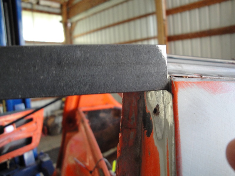

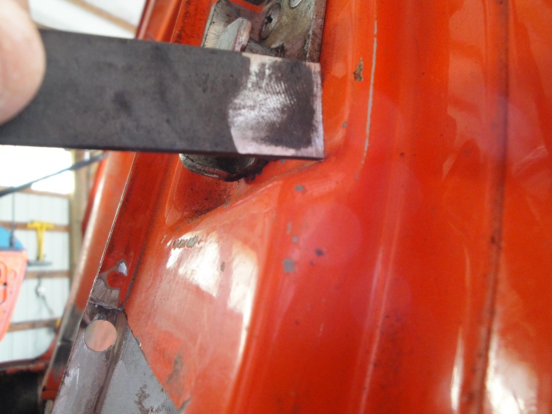

Here's the door gap measurement rods in use.
Top one .............fits perfect.
Now we go to measure the 1039mm measurement at the door latch.
One has to be smarter than a 5th grader.
Considering both planes are at an angle where is the correct spot to measure?
With the door gap set a 5mm. Mine measures right in the middle of the radius.
