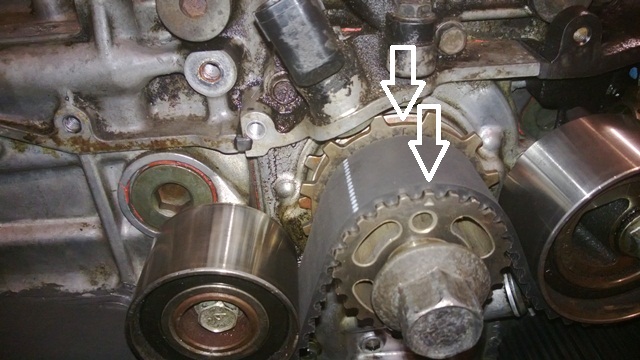

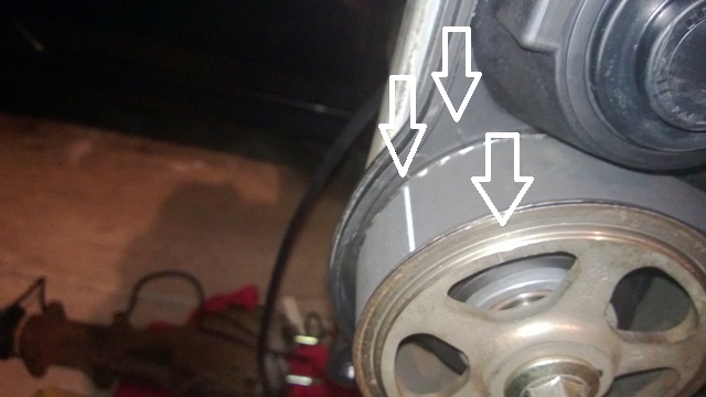

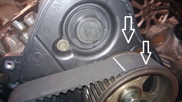

Never done a timing belt before so I wasted a lot of time re-doing it because I thought it was incorrect. Lined up the marks perfectly…cranked the engine one revolution…and the dang belt marks never realigned with the marks on the engine. Apparently they don't have to. The marks are for the initial alignment, so as long as the arrows on the engine line up with the ones on the belt wheels it’s all good. Hope that saves someone a couple hours. And if you screw it up, no worries. The EG33 is a non-interference engine. Didn’t expect that but it’s true. The car won’t run, but you won’t bang the valves against the piston tops.
Left side:
Center:
Right Side:
Note how after one revolution the arrows on the wheel line up with the ones on the engine but the timing belt marks do not.
