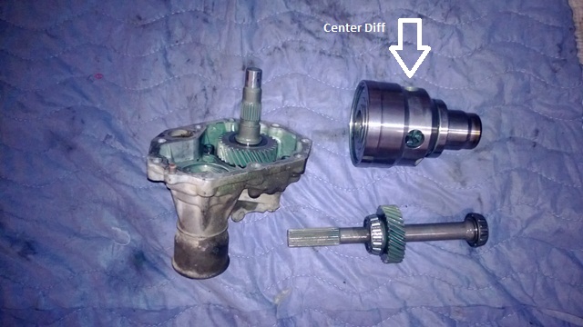

First, the when you take off the center diff, which is the tail section of the trans it’s not immediately obvious what to do next.
Just pull out this stuff:
The center diff is worth between $150 and $300 depending on the year and how many people need it at the time you want to sell it.

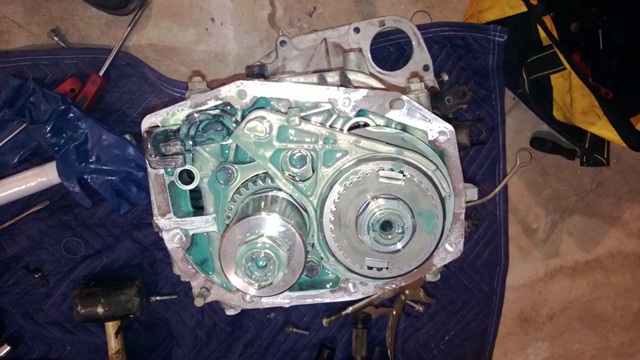

To get the nut off for the diff lock you need to take the next section of trans cover off. You'll probably need a new gasket or some gasket maker. Mine tore into several pieces. It's made of a paper-ish material.

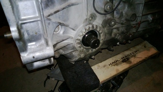

New stubs in...ready to go.

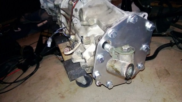

Tail end...the stock bolts are way too long for the cover. Shorter ones are provided in the kit.

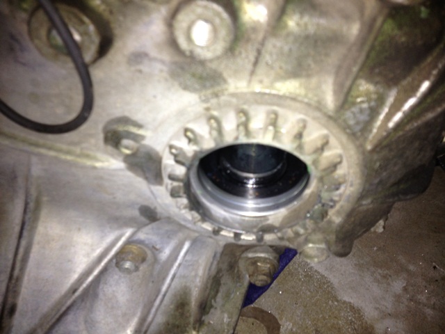

1. If you are installing stub axles be very careful with the axle seals. I bent one by slightly tapping it with a wrench. They should sit flush with the axle holes. I also pushed one in a bit too far but was able to get it out.
This is "way too far" in:
Not quite German quality engineering we're dealing with so things don't all fit with a crisp snap like we are used to.
2. When you remove the middle section of the trans cover to get at the differential nut the gear selector shaft will just fall out onto the floor which is alarming. Don't worry, you did not break it.
