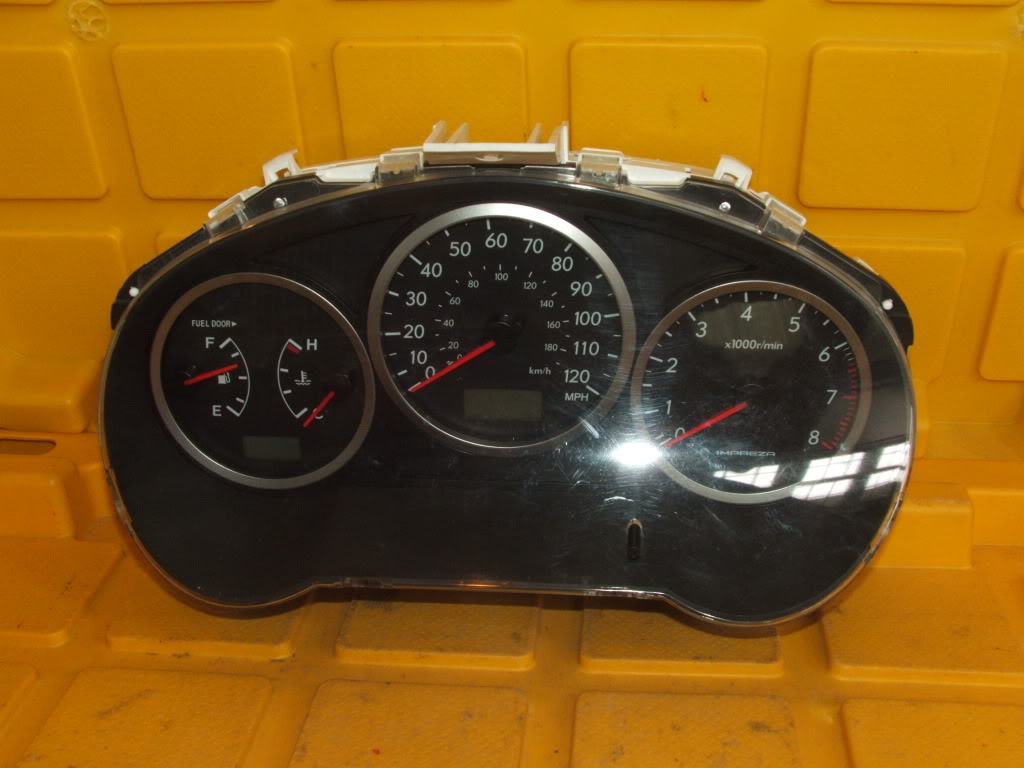

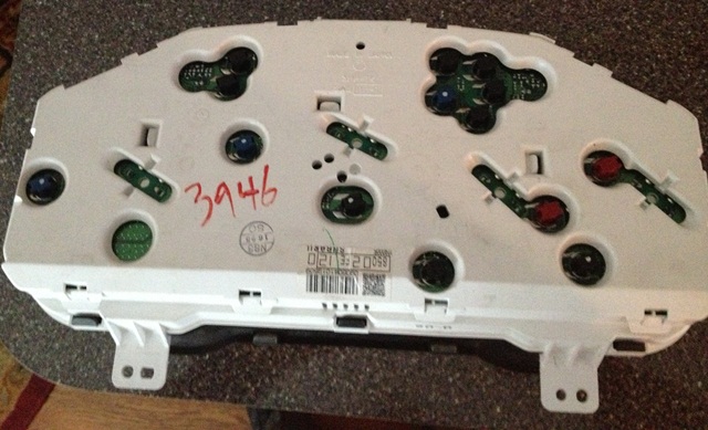

Also bought a very inexpensive 2006 Impreza gauge cluster from e-bay. Thought I could take it apart and not feel bad if I break it for $36. I'd like to see if I can separate the cluster into three separate gauges similar to the stock 914 look....not sure if it's possible but we'll see. I'm torn between this and using an electronic Porsche VDO speedo.
Front:
Back:
Since the gauge is from a 2006 as is the trans the speedo should work. The tach will need an adapter like this one:
Tach Adapt
Temp will be directionally correct and I plan to use an Impreza fuel pump per BIGKAT's recommendation.

strawman   ... been looking at stock Subie gauge clusters......   Jan 27 2013, 01:58 PM
904svo   [quote name='Chris H.' post='1810259' date='Jan 2...   Jan 27 2013, 04:33 PM
strawman   The trouble with using the Subaru Speedo is that i...   Jan 27 2013, 06:49 PM
76-914   Hey Chris, what's that cluster from the SVX lo...   Jan 27 2013, 12:11 PM
Chris H.   SVX's are all automatics...the cluster is a li...   Jan 27 2013, 12:43 PM
Chris H.   Thanks guys.... Geoff if I end up using the stock...   Jan 27 2013, 05:35 PM
DBCooper   There's an aftermarket VDO electrical speedome...   Jan 27 2013, 10:49 PM
Chris H.   Is it this one? Certainly a good option. Fit...   Jan 28 2013, 08:00 AM
DBCooper   Yup, that's it. Found a photo: http://www.91...   Jan 28 2013, 09:13 AM
904svo   It's answer like these that take the scare out...   Jan 28 2013, 11:07 AM
