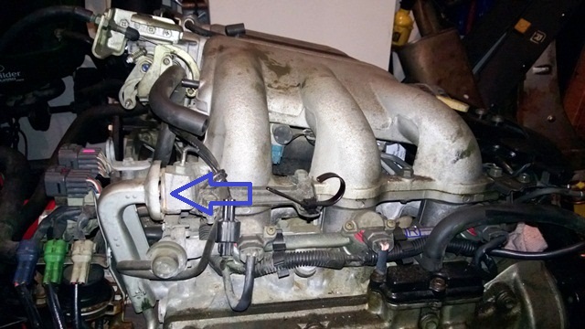

Thanks jcl. Yes most of those seals are on the engine. I have a list of them all if anyone needs it.
JCL when you removed the EGR stuff did you just block off the connection at the intake? Was planning to do that but just making sure I'm not overlooking anything.

Chris H.   Thanks jcl. Yes most of those seals are on the en...   Mar 22 2013, 07:03 AM
