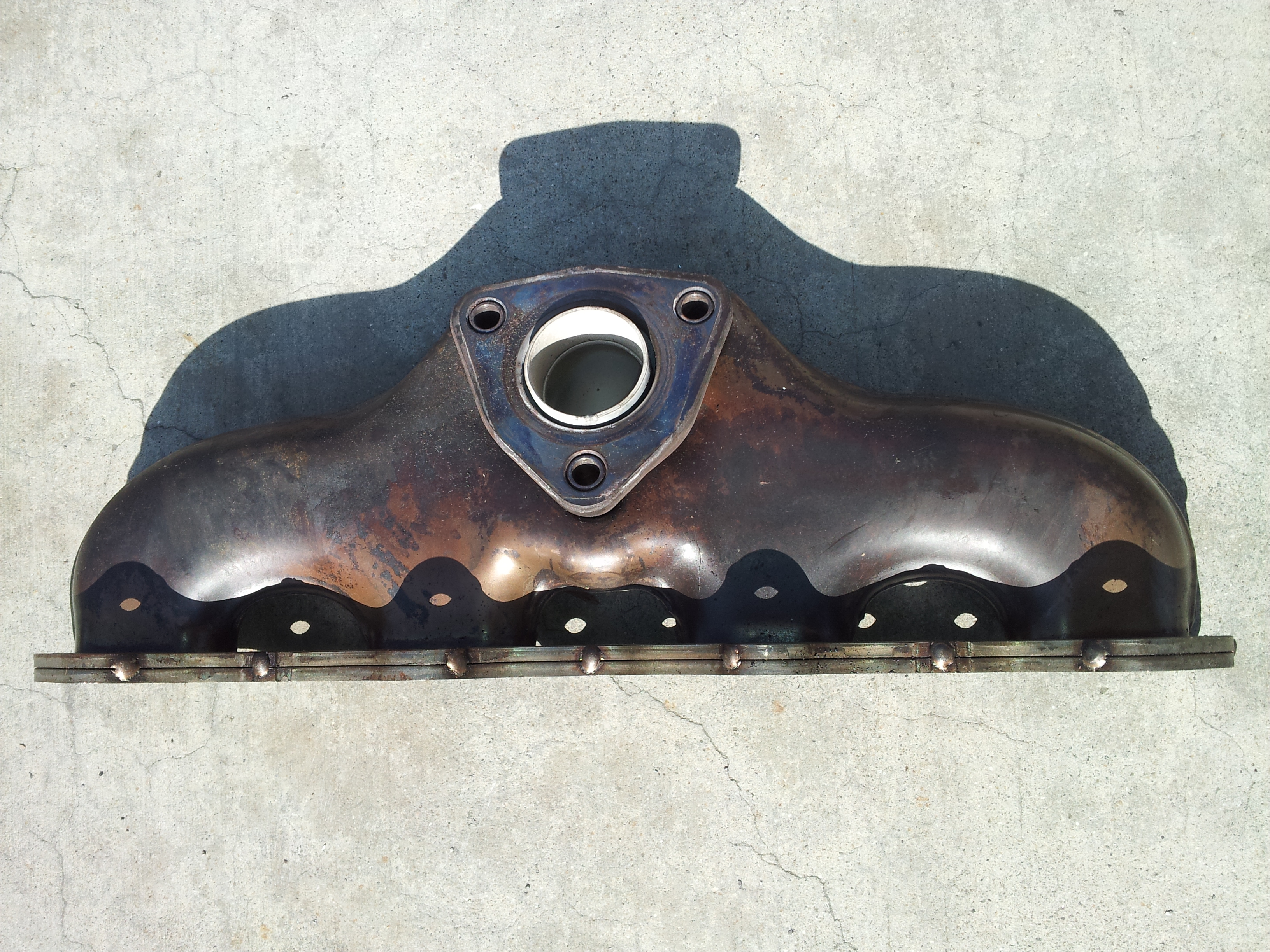

One of the oe turbo exhaust manifolds.
You can just about pass a silver dollar through the discharge.
Too small for our turbonetics gtk.
Not even tubing, just 2 low grade stainless steel clam shells welded together.
We are designing some tubular Shorty turbo headers for decent spooling.Attached Image
