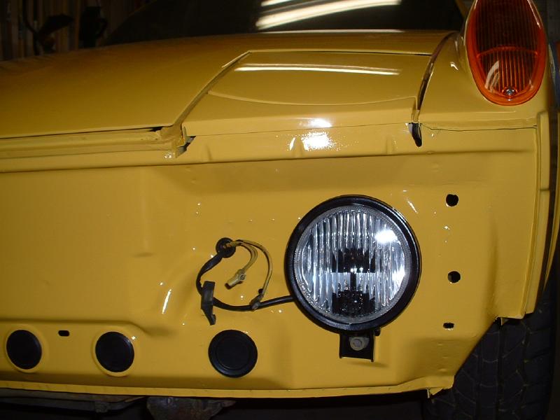

Eric_Shea   Getting near the end... finaly got the horn bits a...   Jul 9 2004, 03:50 PM
Eric_Shea   Bumper needs to be polished and the installed. Go...   Jul 9 2004, 03:52 PM
