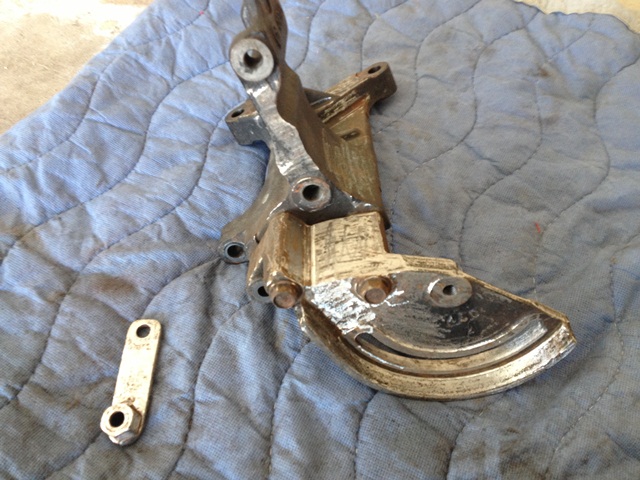

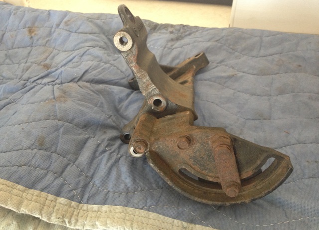

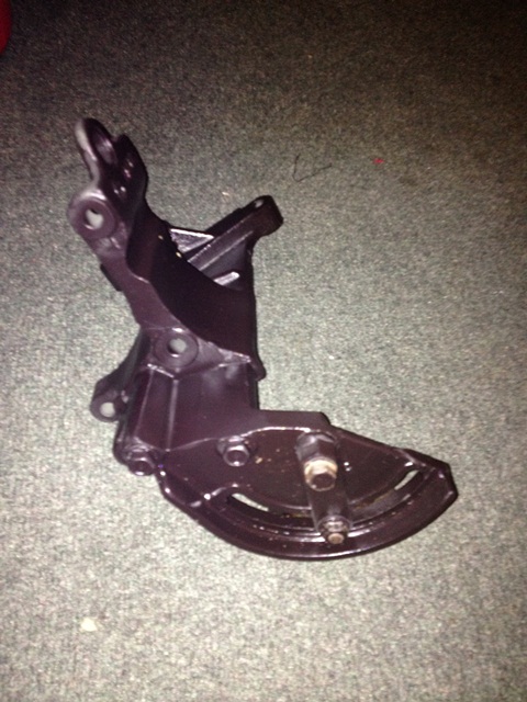

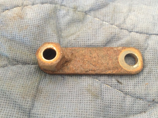

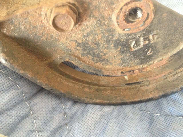

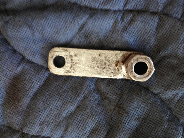

Time to start reinstalling the accessories onto the engine. The AC/alternator bracket had a lot of surface rust so I had to clean it up a bit:
Before:
Ground off the chunky rust:
Painted with high temp paint:
