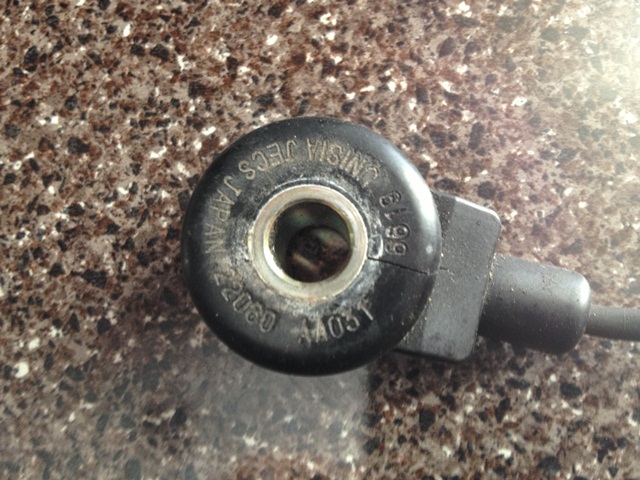

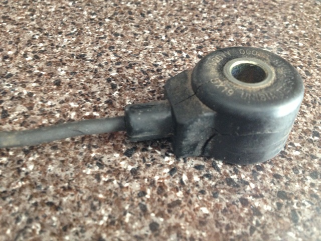

I heard the knock sensors were one of the keys to a smooth running Subie engine. On the subaru-svx site the experts say if there are ANY cracks at all replace them. Just checked mine and both are cracked. You can find them cheap, just ordered two for $12.99 ea on e-bay. Free shipping.
Badly cracked:
One crack:
