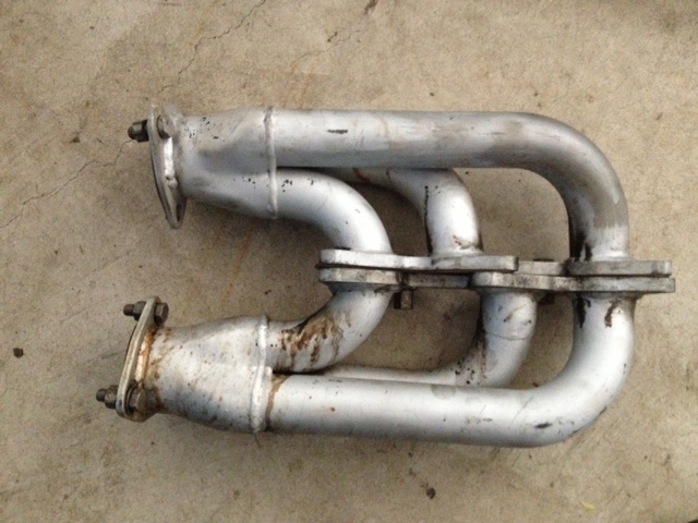

Nice. Picked these up from Bob (BIGKAT) along with a custom built exhaust. One less thing to mess up for me!
76-914
Nice snag Chris. Did Bob make those?

Chris H.   Nice. Picked these up from Bob (BIGKAT) along wit...   Mar 22 2013, 09:04 AM
76-914   Nice. Picked these up from Bob (BIGKAT) along wi...   Mar 28 2013, 09:09 PM
a914622   sweet. And it looks like they dont have the ...   Mar 23 2013, 07:33 AM
Chris H.   sweet. And it looks like they dont have the ...   Mar 24 2013, 02:56 PM
