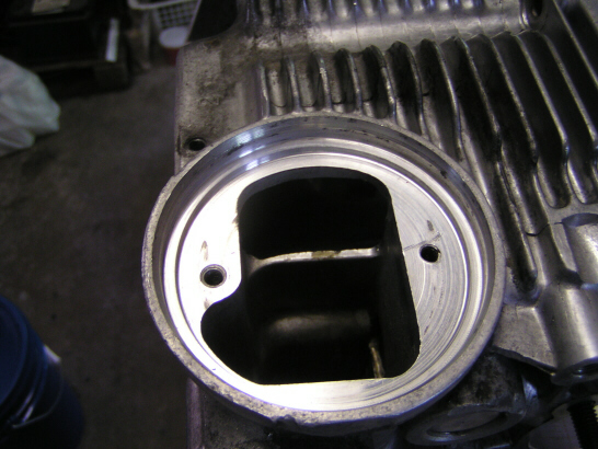

Taco plate area

DNHunt   Tonight wasn't as fun as last night. I spent t...   Jun 30 2004, 09:34 PM
DNHunt   Taco plate area   Jun 30 2004, 09:38 PM

Jake Raby   Even the "anal retentive" Naval Turbine instructor...   Jun 30 2004, 09:48 PM
brp914   I didn't see it mentioned here, so I will: ...   Jun 30 2004, 10:08 PM
Jake Raby   Brp, My rods have zero offset... They can be insta...   Jul 1 2004, 06:54 AM
DNHunt   True no numbers but, there is plenty of red paint ...   Jul 1 2004, 07:31 AM
Jake Raby   There is no substiute for Indexed parts!   Jul 1 2004, 07:33 AM
Joe Ricard   How come # 2 connecting rod is the first one from ...   Jul 2 2004, 02:33 PM
Jake Raby   It doesn't matter where they go... We number t...   Jul 2 2004, 04:46 PM
Joe Ricard   Damn, thats cool. who woulda thunk that them Engi...   Jul 2 2004, 07:27 PM
