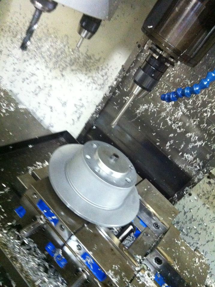

Rear Rotors waiting their turn in line on the mill:

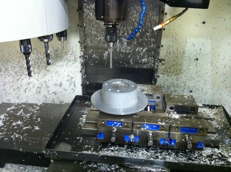

The rotor is dropped onto a peg in the fixture...
(IMG:http://www.914world.com/bbs2/uploads_offsite/sphotos-a.xx.fbcdn.net-1110-1364573931.2.jpg)

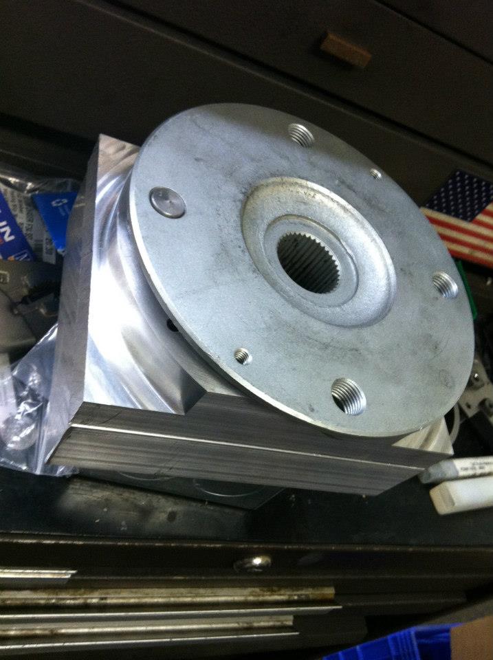

...then the cap is mounted to keep everything rock solid-steady:
(IMG:http://www.914world.com/bbs2/uploads_offsite/sphotos-b.xx.fbcdn.net-1110-1364573931.3.jpg)

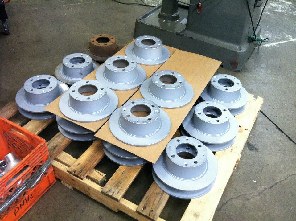

Late model front rotor will get the centering ring machined off to accommodate the 5x130 Fuchs wheels. This one is being test fit onto the jig.
(IMG:http://www.914world.com/bbs2/uploads_offsite/sphotos-a.xx.fbcdn.net-1110-1364573931.4.jpg)

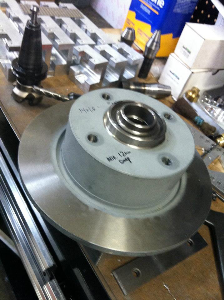

The jig for the rear hub is ready to go. The hub is dropped onto the pin and also indexed by the M6x1 mounting holes.
(IMG:http://www.914world.com/bbs2/uploads_offsite/sphotos-a.xx.fbcdn.net-1110-1364573931.5.jpg)
