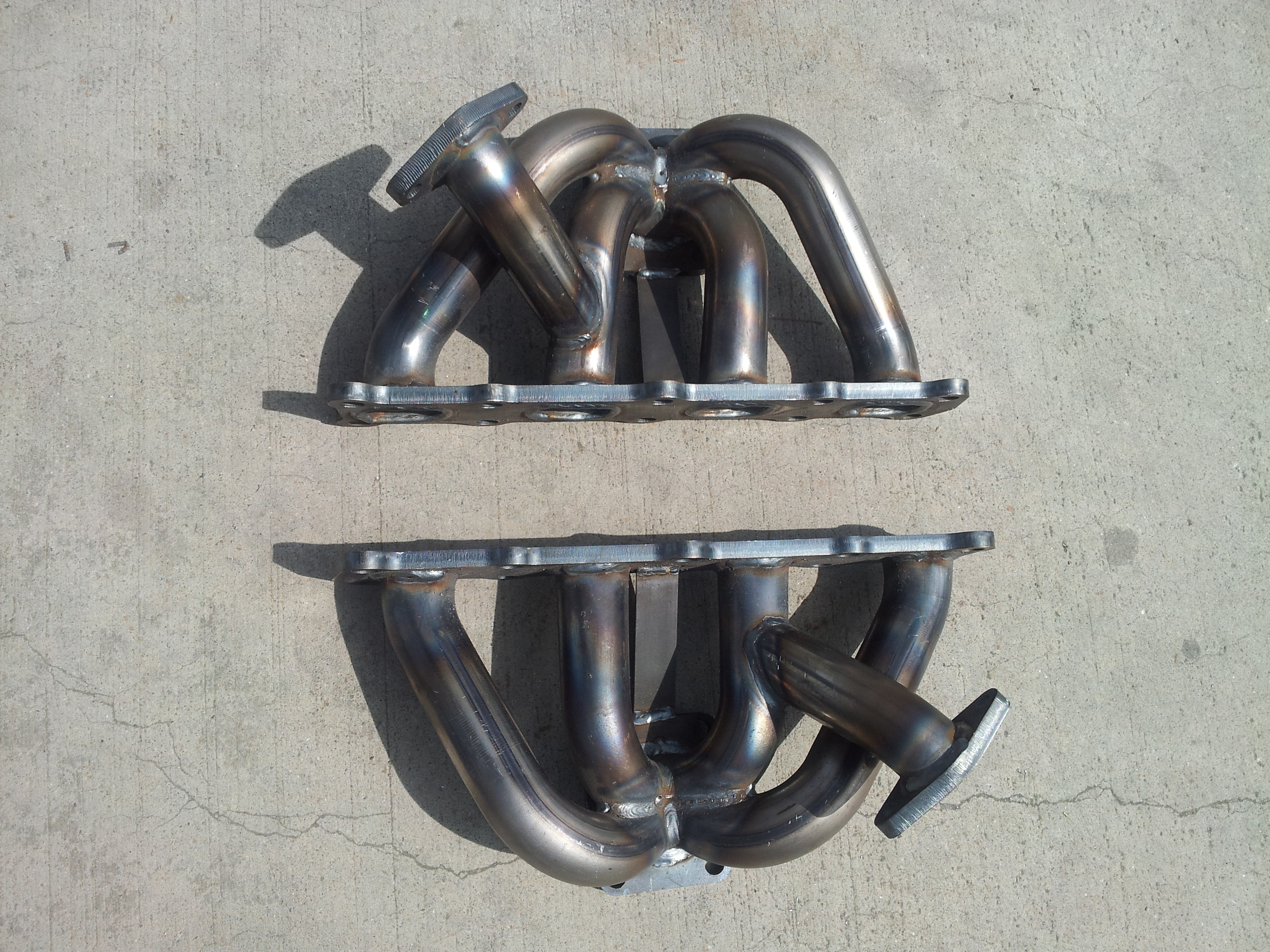

Deep breathing for the new gtk's . Mandrel formed, Laser cut flanges ,
better spool up time. Attached Image
