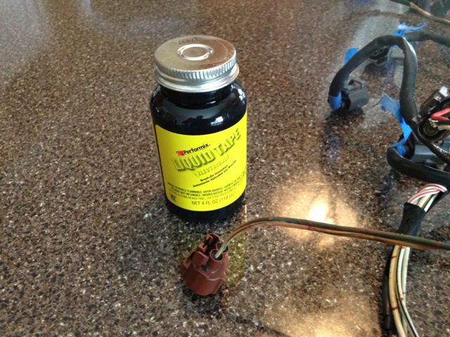

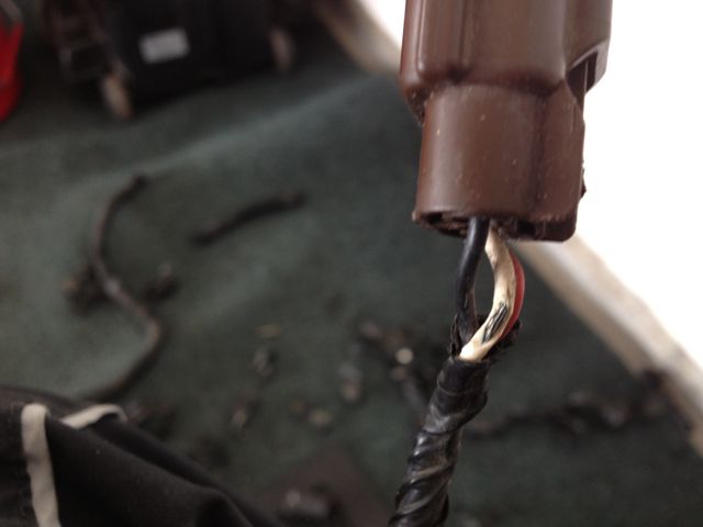

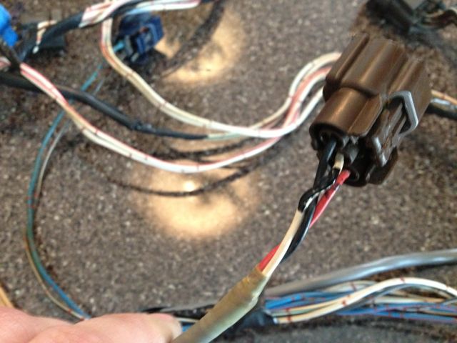

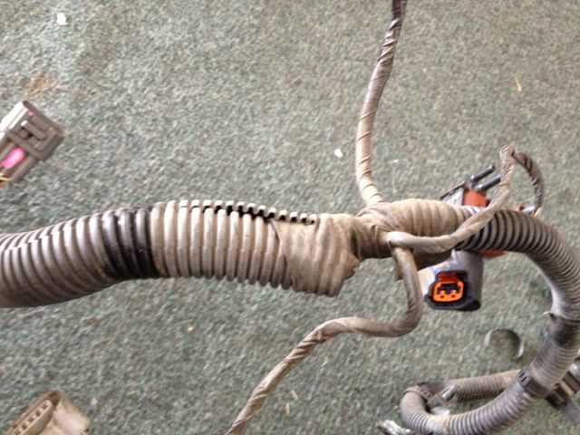

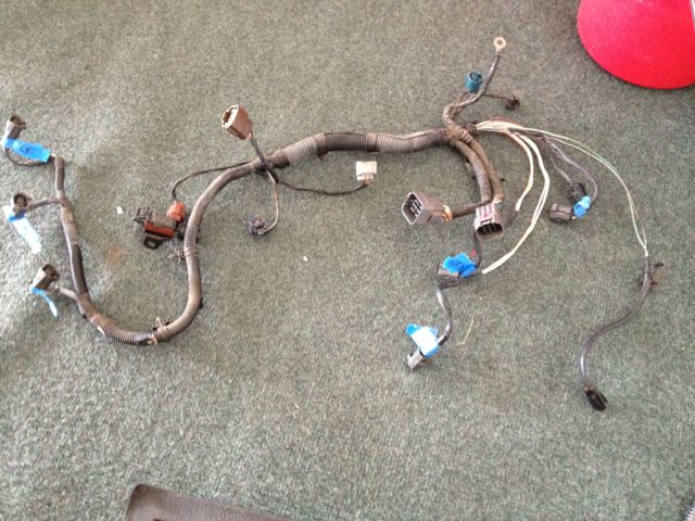

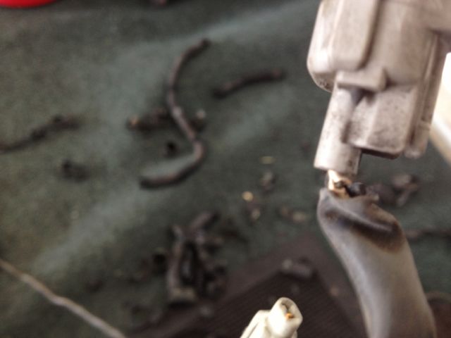

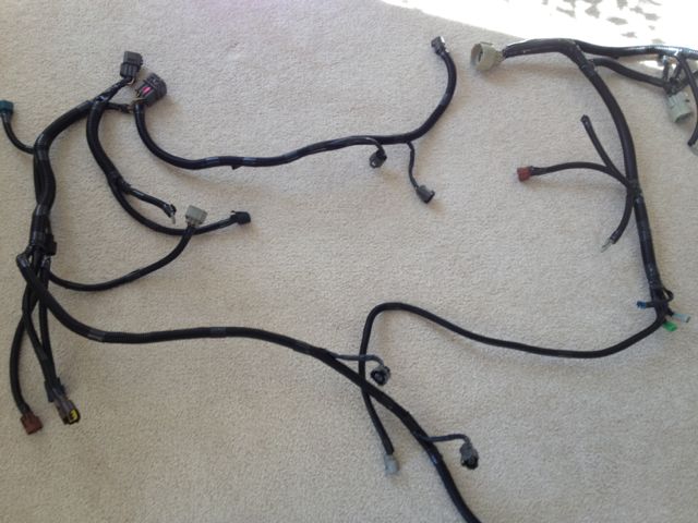

Tackled the engine wiring harnesses....
Because there was a gathering of nesting materials under the intake the wiring needed to be checked pretty closely. Mice love to chew through 914 wires as we know, but it looks like Subie wires don't taste quite as good.
Before:
Nothing was chewed, but there were some nicked wires, which likely explained the blinky lights on the dash. It was raining when I bought the car and every time I started it a different set of warning lights lit up. The engine ran great so I figured it was a wiring issue...
A little liquid tape..then regular electrical tape
And the end result:
The OEM covering was plastic tubing that can be found at Harbor Freight. It held up surprisingly well so that's what I replaced it with. The wiring underneath was very healthy and pliable. Of course I covered every last one even though it was not necessary... (IMG:style_emoticons/default/biggrin.gif)
Next up are the vacuum hoses, reinstall intake, alternator, etc. Then the main wiring harness. I want to test fire the engine before I put it in the car so that it will be easy to troubleshoot if there is something not connected right, etc.
