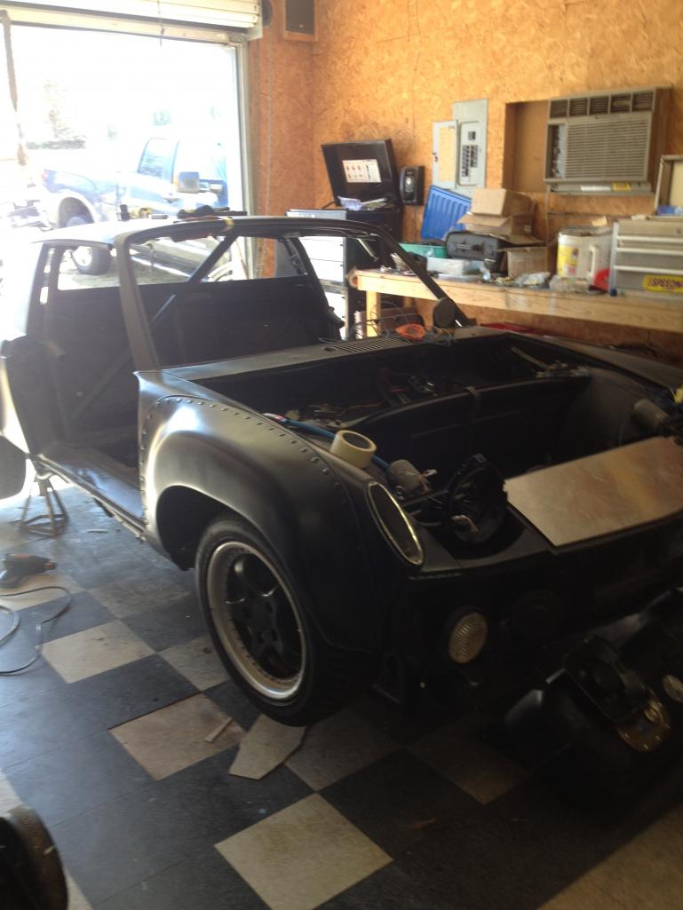

The long EPIC continues.. 6 maybe 7 years into it... Life does get in the way..
We move the car to Bob's house.... Thank GOD for bob or this car would never get done!!
Here it sits in its new home..
The engine is wired, plumbed and has the fuel lines in place..
Need a different Fuel press reg.. old one doesnt match up to he new fuel rails..

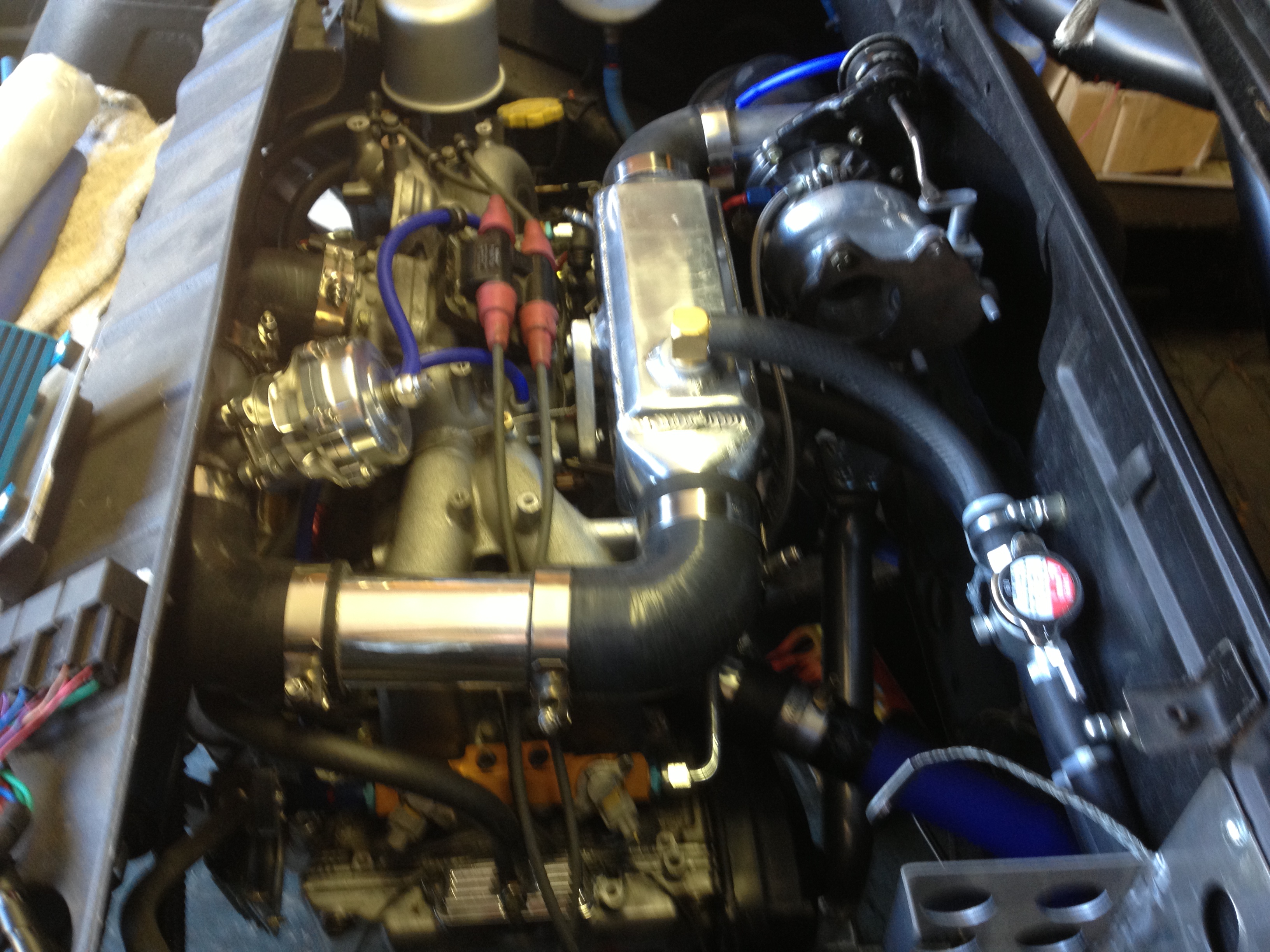

d914   Radiator is in and plumbed.. Re-designed the in...   Apr 6 2013, 11:47 AM
d914   Wiring is 70% done... using hot rod Harness and wi...   Apr 6 2013, 11:51 AM
d914   answers from the past... I believe I will be usi...   Apr 6 2013, 11:58 AM
