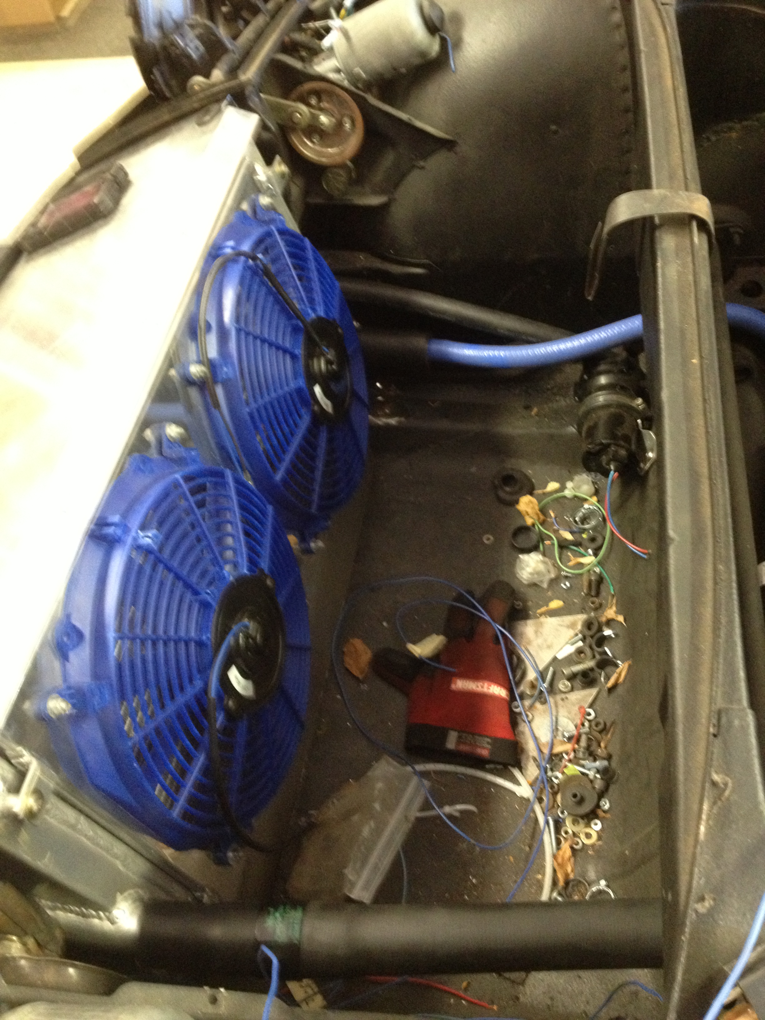

d914   The long EPIC continues.. 6 maybe 7 years into it....   Apr 6 2013, 11:39 AM
d914   Radiator is in and plumbed.. Re-designed the in...   Apr 6 2013, 11:47 AM
