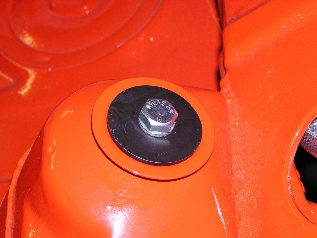

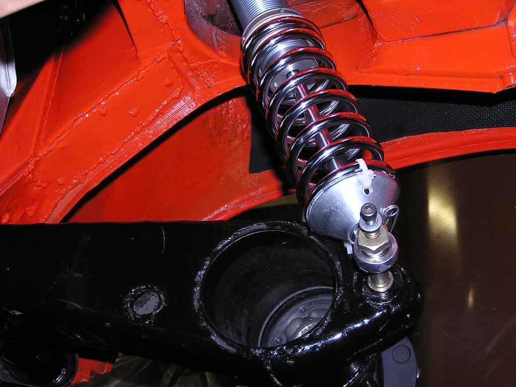

inverted shocks with aluminum bodies. Custom length for a lowered car and custom valving :

QUOTE(brant @ Apr 9 2013, 05:16 PM) *
Can you show how those are mounted at the top, from inside the trunk, or just simply mocked up?
Must be more parts I am not seeing...
What benefit have you found using those versus a Koni or Bilstien?
can they be adjusted, or are these setup to spec and you live with them?

QA1
a few more suspension pictures in my vintage build thread in the signature.
when you a lower a car, the koni's and street car shocks are out of their range of travel. So you are hitting the bump stops all of the time and the shocks will blow their seals in no time. I learned the hard way after replacing koni's on an annual basis...
these are a shorter body.
their "range" of travel is different and they effectively still have travel on a lowered car. Plus the valving can be tailored for the car and spring rates, tracks ideally if you get that advanced..... (I don't)
most amateurs don't change spring rates each weekend for each event.... just like we don't change shock valving ( or gearing ) each weekend.....
