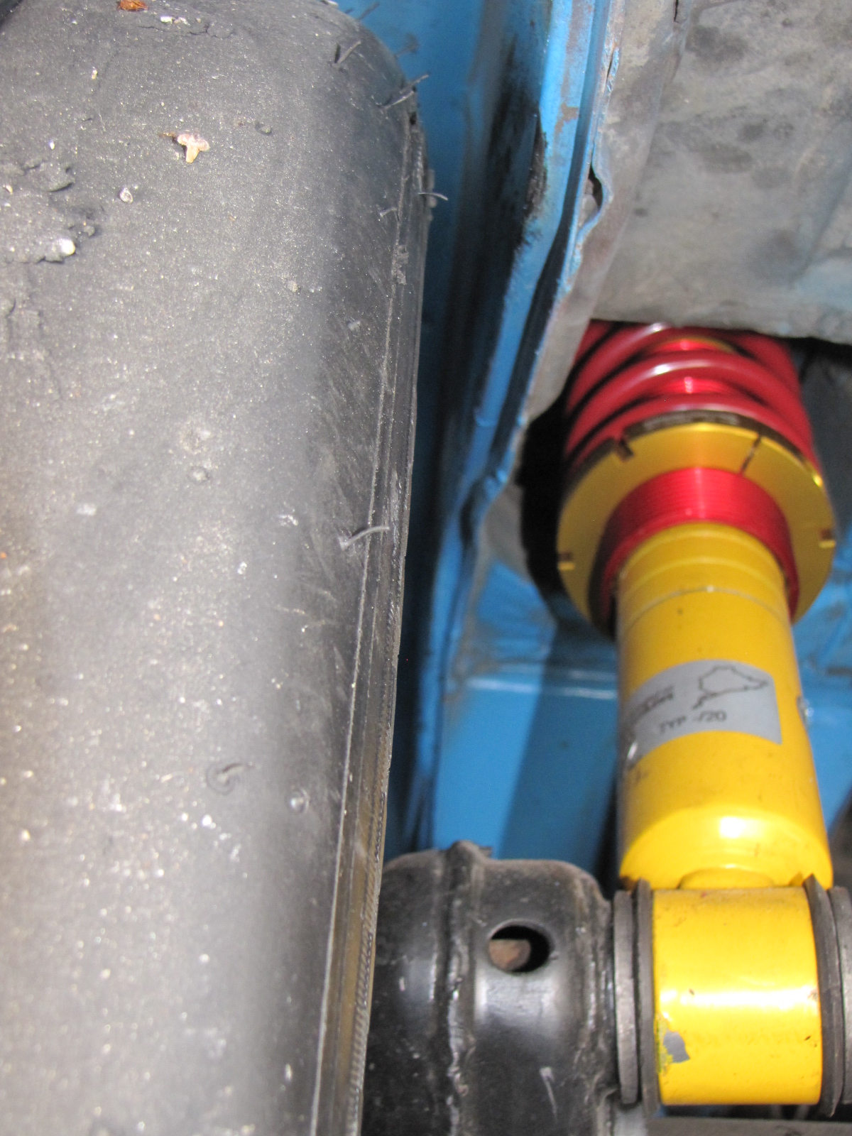

Here is the clearance inside the fender. The coilover is on the 4th perch.

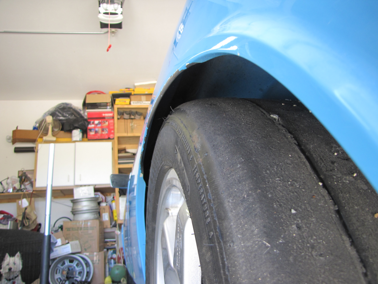

Here is the clearance after I rolled the fender. In this shot I could barely get one finger in between, so I pushed the fender out about a 1/4" with a jack.

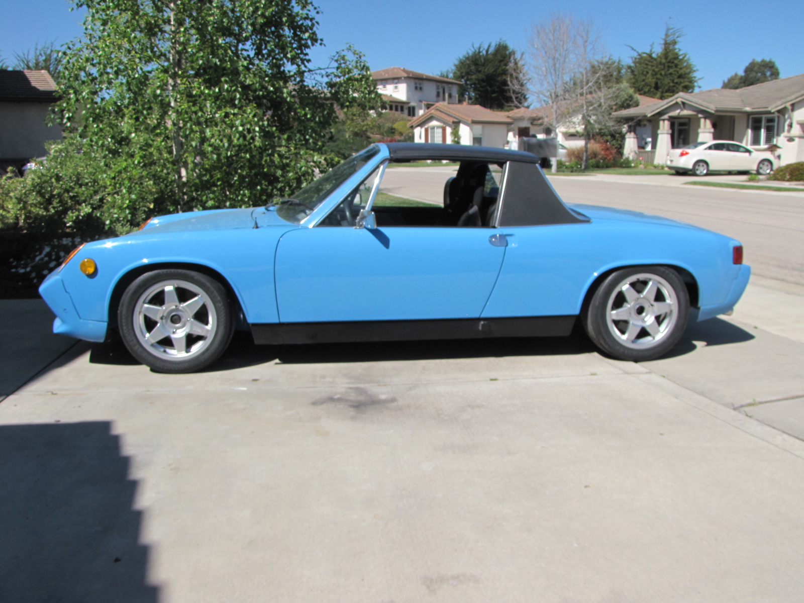

Here is the way the car sits. The measurement from the middle of the fender to the ground is 207/8" in the rear, 2211/16" in the front. EDIT: I forgot to mention that the wheels are Revolution 7x15s and the tires are Hoosier A6 205x15x50ZR, with a 1/4 in spacer. I run Falken 205x15x55 and 195x15x55 on 5.5 Fuchs on the street. The street setup did not need rolled fenders. It was just the wider track A6s that needed the mods.
