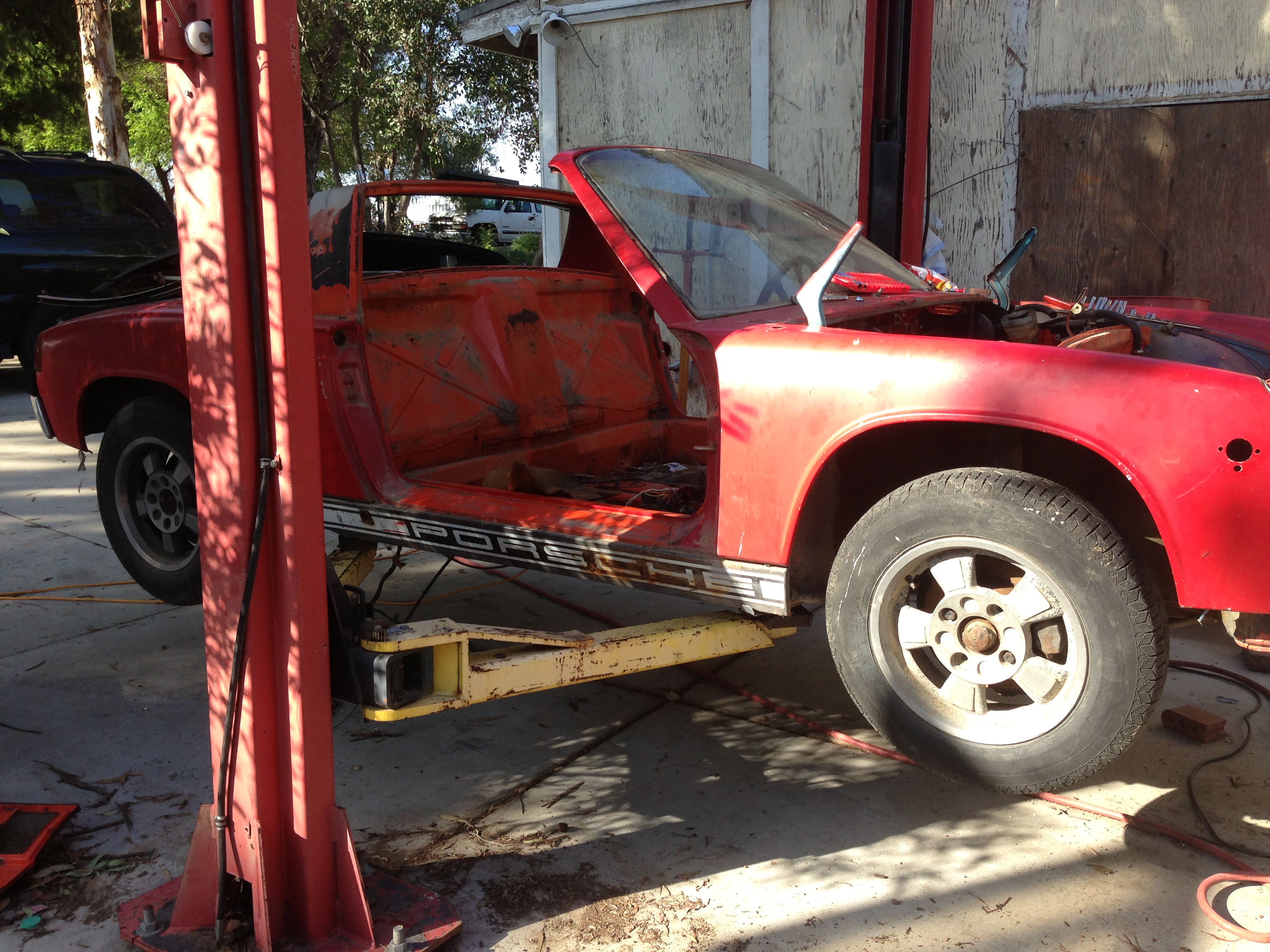

Well the dream begins. I'm embarking on the building of a 914 project. Here is the candidate. Bought a roller from LA area. Looks like its not going to be too much rust. Firsts thing will be to strip it. Taking front fenders and rear quarters off. Then sending to Cal Blast for media blasting. I look forward to the knowledge that I can gain from fellow enthusiasts. Plan on taking a lot of pics Stay tuned......
DISCLAIMER: Do not attempt to duplicate anything that is mentioned or illustrated in the entirety of this thread. I do not make any warranties of any kind. If you try to build what I am doing, you take full risk. Do not try this. It may be dangerous to your health and may get you killedAttached Image
