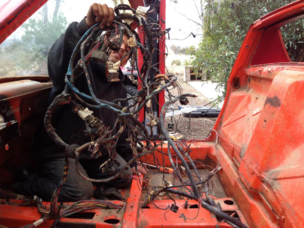

Bundle of wires

Jgilliam914   Take good care of that Harness! Your gonna nee...   Apr 16 2013, 01:00 PM
Curbandgutter   Thank you for the suggestion. Also with respect t...   Apr 16 2013, 02:22 PM
