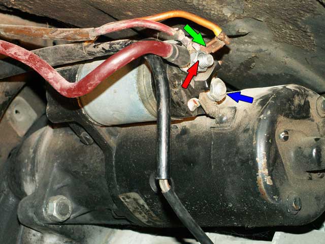

It only takes a minute to jump the solenoid as suggested. One minute and you will rule out half of the troubleshooting process. Just make sure it's in neutral and get under there with a screwdriver and short from red to green arrow in this pic...

ericoneal   "In that picture, the red wire is the starter...   Apr 18 2013, 10:19 AM

ericoneal   It worked! The starter turned and it sparked ...   Apr 18 2013, 07:11 PM
Rand   It worked! The starter turned and it sparked...   Apr 18 2013, 08:23 PM
