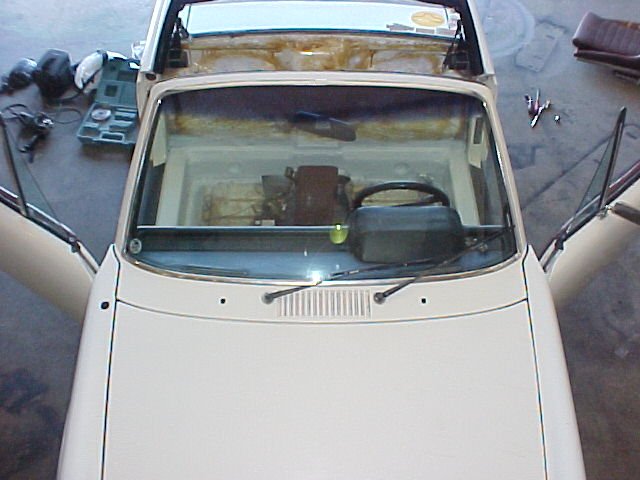

Believe me I want to. I have over 50 shots of the entire install start to finish as a photo documentary ready to post.
It's not time yet...sorry.
I'll give one teaser. (IMG:style_emoticons/default/monkeydance.gif)
