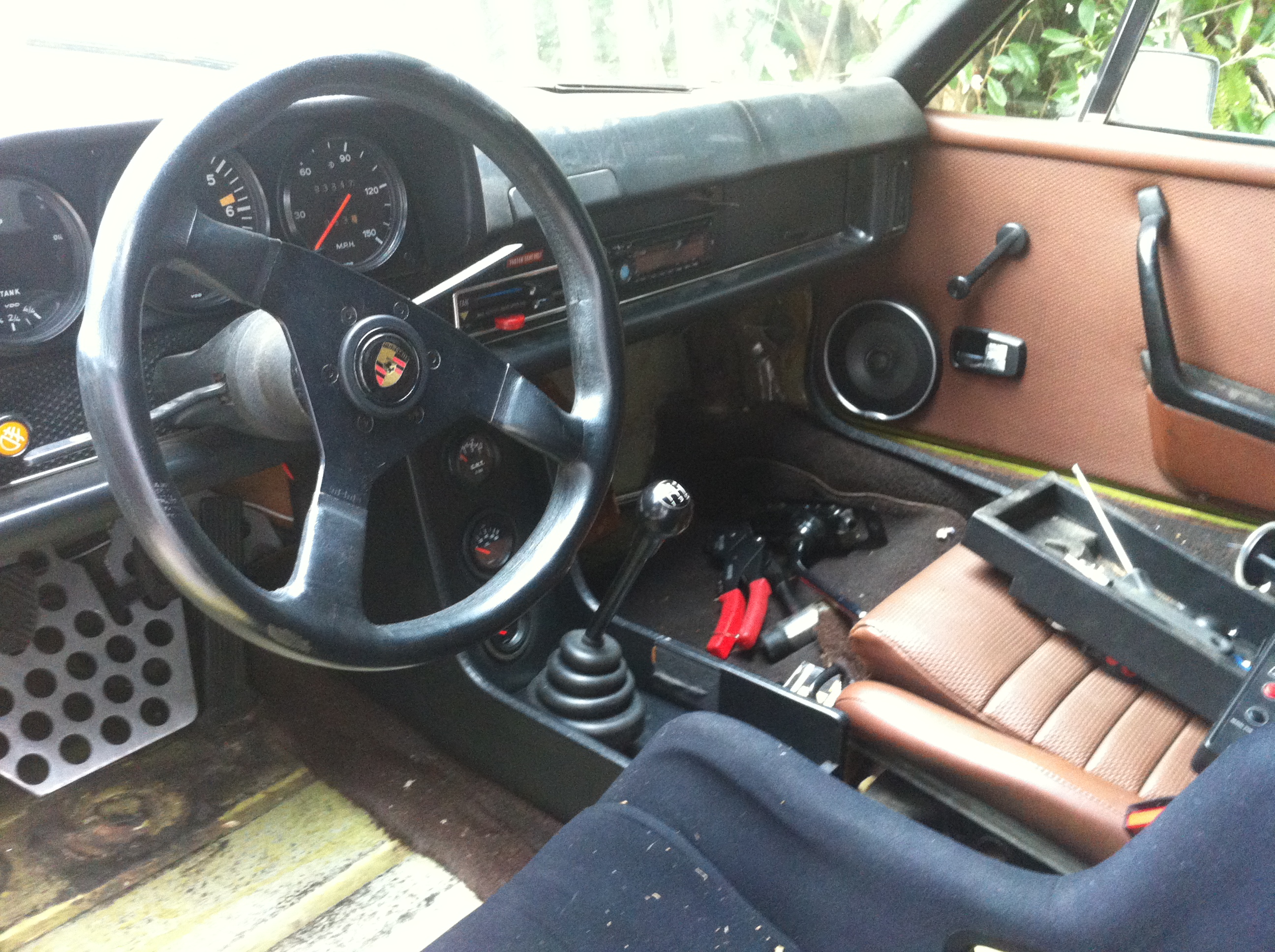

Had some minor surgery on my throat last Monday, so it's been nothing but percocet, discovery channel, and apple sauce for the past 10 days or so. Today I did manage to install my used Rennshift!
I massaged the center console to allow it to work with the new shifter. Now as soon as my replacement dizzy cap comes tomorrow I can test it. Sure feels nice though!
