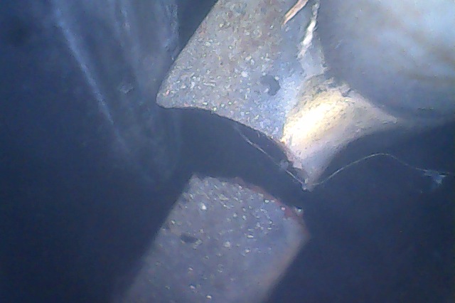

It did make a "squeak" that seemed to be coming from the center tunnel. I found this with my cheap scope.
I think that's left over from when my clutch tube broke out. It's just past the reinforcement (I think) in the center tunnel; very close to the heater flap lever. What you see is the shift rod running from the upper left toward the center of the picture. It's obviously scraping on that broken mount. So, while I have the welder out to fix the crack in my inner longitudinal I'll cut open the tunnel and fix this up too. I guess the Rennshift must put the shift rod at a slightly different angle than the stock shifter does as I never would have noticed this without changing shifters.

Broke exactly where mine did, alo firewall and front. Prolly worth fixin.
