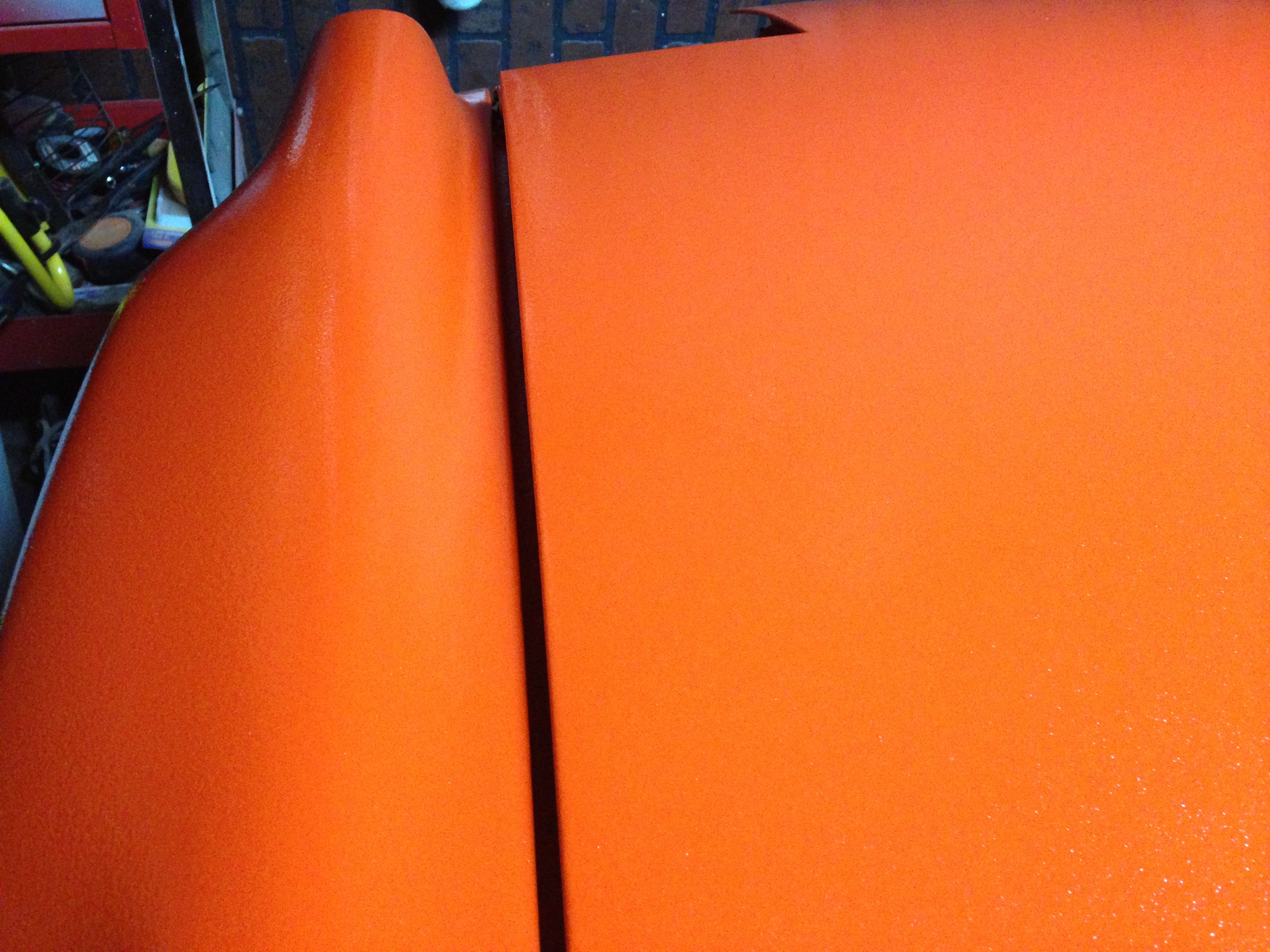

Update
I manage to sand down to the paint and reprinted the whole car with primer / surfacer. Once the primer dried, (30 mn)I then sprayed my base, 4 coats and 3 coats of clear. I didn't have any reaction, it all went well. No orange peals, no fish eyes no runs. My only concern is that after spraying the clear, I noticed that its a bit grainy. It was a bit windy , that may be the cause. I never use clear before, I hope they smooth out with wet sand and buffing. Attached thumbnail(s) |

914itis More May 4 2013, 07:11 PM
bulitt Yup. the clear should come out fine. Be careful s... May 4 2013, 07:15 PM
Andyrew Can you put a florescent above and take another sh... May 4 2013, 07:48 PM
914itis Yes it is the clear only. May 4 2013, 07:51 PM
scotty b that Is orange peel. Wet sand it. If you want to b... May 4 2013, 07:56 PM
Andyrew
that Is orange peel. Wet sand it. If you want to ... May 5 2013, 11:38 AM
914itis Thanks all, will start wet sanding in 24 hours and... May 4 2013, 08:15 PM

914itis Another 4 Hours of wet sand today. that makes it a... May 6 2013, 08:52 PM
scotty b 2
DO NOT buff those spots before doing this. now... May 7 2013, 06:00 AM
914itis Thanks, is there a time frame to buff after wetsan... May 7 2013, 06:05 AM
scotty b
Thanks, is there a time frame to buff after wetsa... May 7 2013, 11:51 AM
