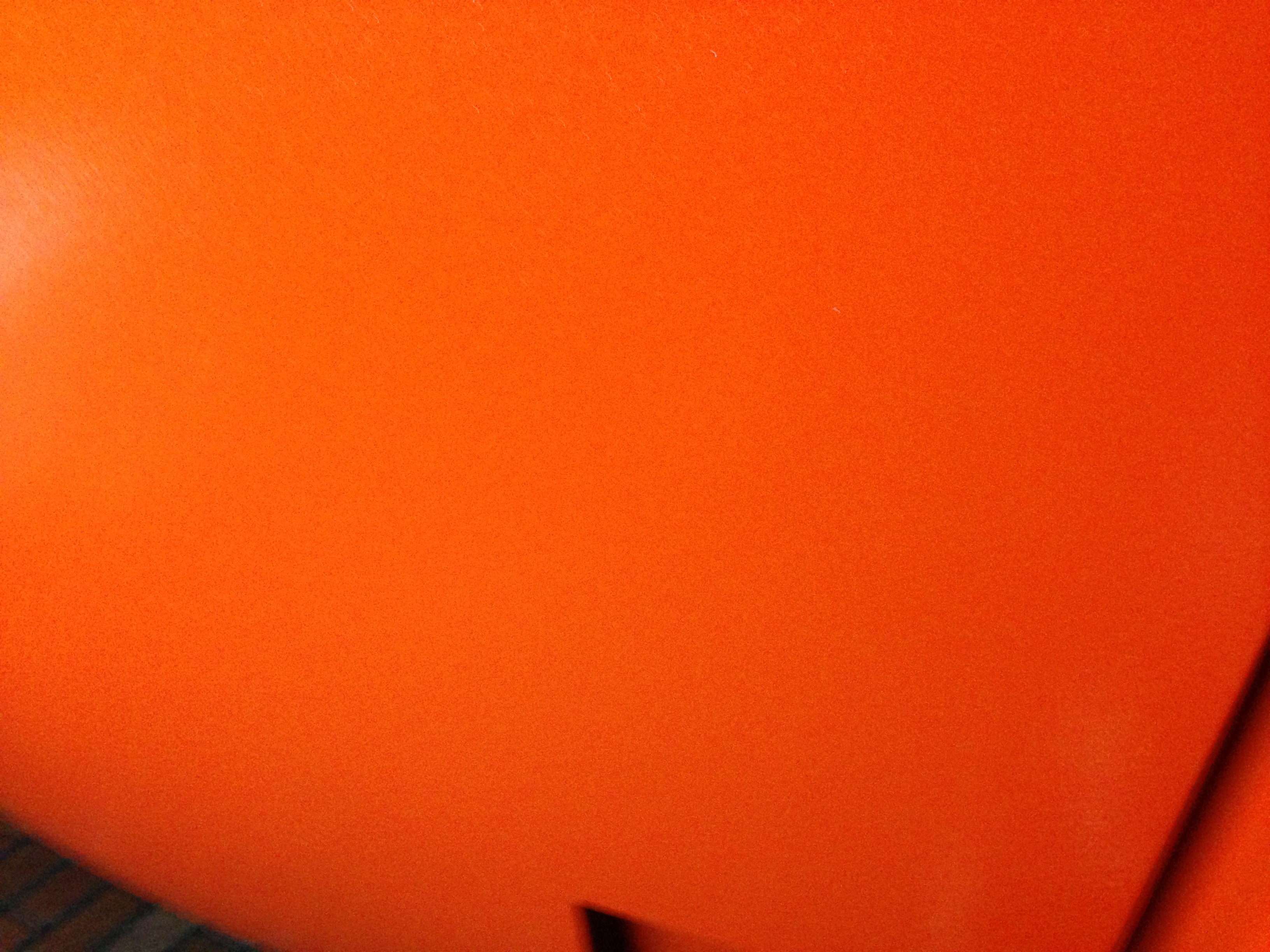

I sprayed a 2 stage paint for the first time. I primed with a 2 k primer cut with thinner, waited an hour spray the base coat, 3 coats then clear coat.
I am not sure If i miss some spots or if it is a reaction, for some reason, I can see the primer under the paint. It's hard to see but can be seen with enough lighting.
It can be see in a few areas.
What did I do wrong and how do I correct this ?

914itis   Update I manage to sand down to the paint and rep...   May 4 2013, 07:09 PM
914itis   More   May 4 2013, 07:11 PM
bulitt   Yup. the clear should come out fine. Be careful s...   May 4 2013, 07:15 PM
Andyrew   Can you put a florescent above and take another sh...   May 4 2013, 07:48 PM
914itis   Yes it is the clear only.   May 4 2013, 07:51 PM
scotty b   that Is orange peel. Wet sand it. If you want to b...   May 4 2013, 07:56 PM

914itis   Thanks all, will start wet sanding in 24 hours and...   May 4 2013, 08:15 PM

914itis   Another 4 Hours of wet sand today. that makes it a...   May 6 2013, 08:52 PM
scotty b   2 DO NOT buff those spots before doing this. now...   May 7 2013, 06:00 AM
914itis   Thanks, is there a time frame to buff after wetsan...   May 7 2013, 06:05 AM
scotty b   Thanks, is there a time frame to buff after wetsa...   May 7 2013, 11:51 AM
914itis   Update After gathering everyone's profession...   May 14 2013, 09:34 AM

914itis   Final product.   May 21 2013, 06:52 PM
ThePaintedMan   Way to go Paul! You did it right by repainting...   May 21 2013, 07:04 PM
914itis   Thanks, a bit of patience, and yes I learned a lot...   May 21 2013, 07:20 PM
914itis   iPhone and glare from the hot sun today. Scotty w...   May 21 2013, 07:33 PM
