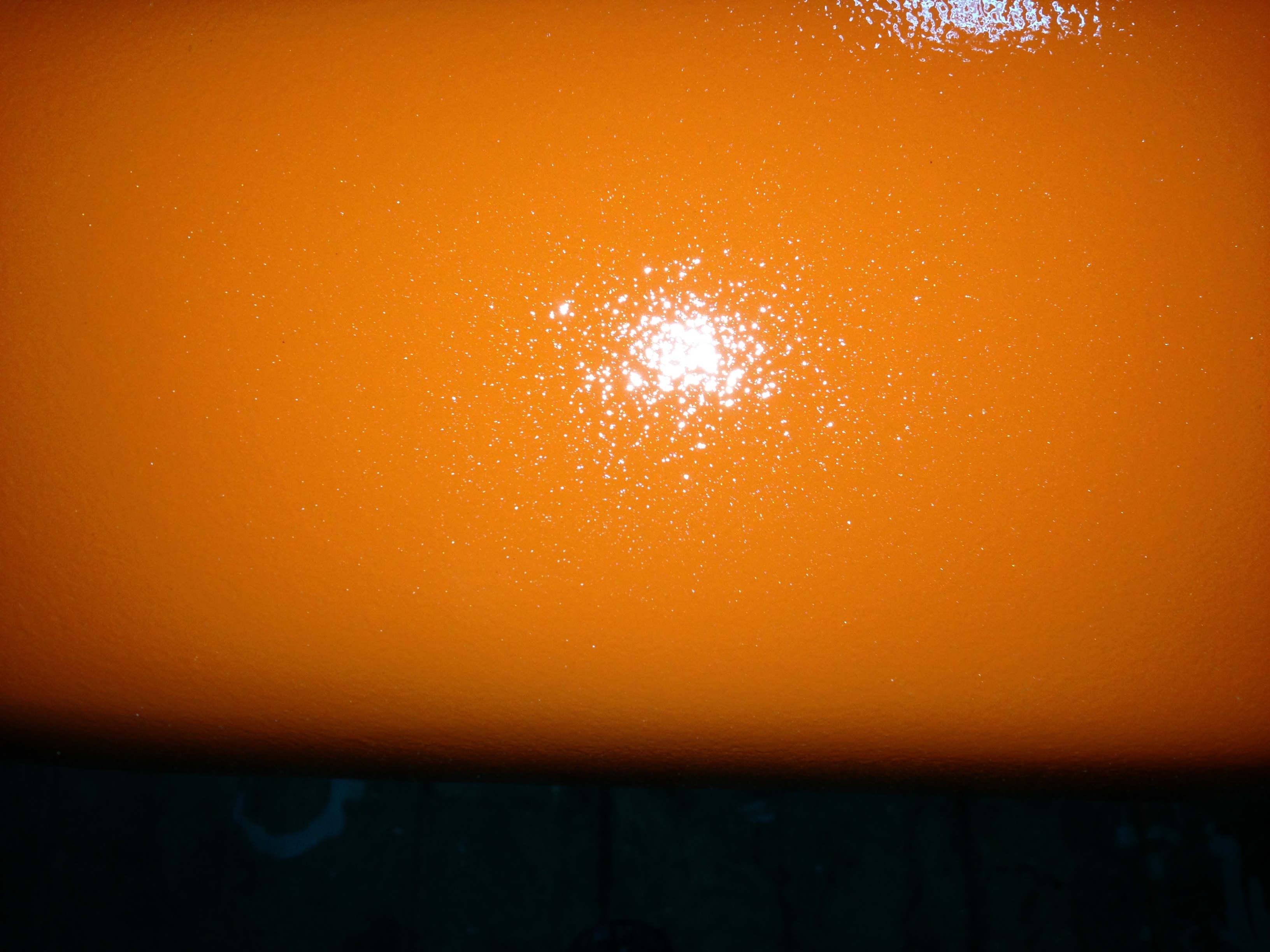

914itis   Update I manage to sand down to the paint and rep...   May 4 2013, 07:09 PM
914itis   More   May 4 2013, 07:11 PM
bulitt   Yup. the clear should come out fine. Be careful s...   May 4 2013, 07:15 PM
Andyrew   Can you put a florescent above and take another sh...   May 4 2013, 07:48 PM
914itis   Yes it is the clear only.   May 4 2013, 07:51 PM
scotty b   that Is orange peel. Wet sand it. If you want to b...   May 4 2013, 07:56 PM

914itis   Thanks all, will start wet sanding in 24 hours and...   May 4 2013, 08:15 PM

914itis   Another 4 Hours of wet sand today. that makes it a...   May 6 2013, 08:52 PM
scotty b   2 DO NOT buff those spots before doing this. now...   May 7 2013, 06:00 AM
914itis   Thanks, is there a time frame to buff after wetsan...   May 7 2013, 06:05 AM
scotty b   Thanks, is there a time frame to buff after wetsa...   May 7 2013, 11:51 AM
